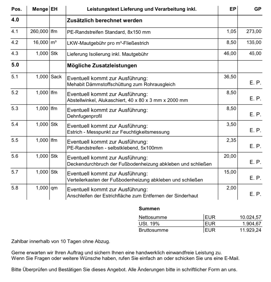

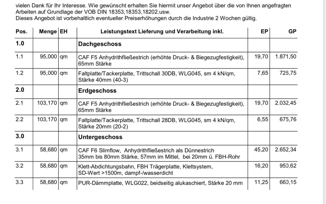

I have received the following quote for our screed.
The installation of the insulation panels is included in the price.
It seems a bit high to me... what do you think?
I don’t have any comparison quotes yet but will invite other screed contractors for an inspection.
However, I would like to get an idea if the prices from other companies will be in a similar range.

nordanney11 Nov 2024 09:43OzCi1305 schrieb:
Since the basement floor is quite uneven and to ensure proper pipe coverage, the thickness varies between 35 and 80 mm (1.4 and 3.1 inches).
What alternatives do I have? Then the height is leveled out and only a small amount of screed is applied accordingly.
I hope the foundation slab is rather too thick than too thin, so you won’t have any issues if it is, in the worst case, 50 mm (2 inches) too thin.
Is the basement a utility basement or a livable basement?
Buchsbaum066 schrieb:
Naturally, you always have more moisture there than on the upper floors. Why? Yes for an old utility basement, but definitely not for a new build with a waterproof concrete tank (white tank).
As I said, the price is reasonable. You really won’t save much with cement screed.
nordanney11 Nov 2024 10:01OzCi1305 schrieb:
What problems could arise with the thickness of the floor? Well, if the concrete slab was supposed to be 12cm thick but in some areas it measures only 7cm (assuming that the spots needing a lot of screed were poured too thinly), that is a defect where in new construction you would say: remove everything and redo it. The reinforcing steel must be properly embedded in the concrete.
But in an older building, you have no idea how it was built. You can’t really worry about it too much.
OzCi1305 schrieb:
So far it was a utility basement, now it’s being converted into a living basement. So you can expect higher moisture exposure. In that case, it’s better to avoid anhydrite screed.
OzCi1305 schrieb:
How should the floor be leveled beforehand? For example, with a (bonded) fill material. Self-leveling compound will likely blow your budget and the differences in height are too big for that anyway.
nordanney11 Nov 2024 10:14P.S. However, thin-layer systems are only available with gypsum-based binding. If height is an issue, then there are no alternatives.
