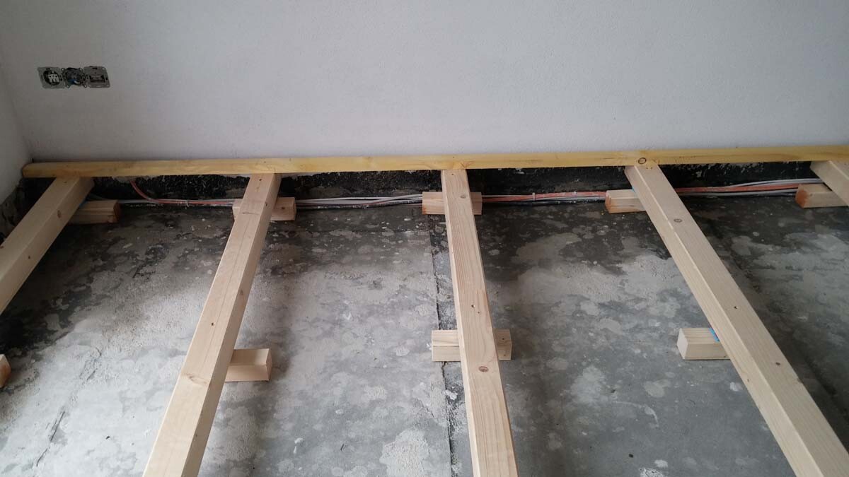

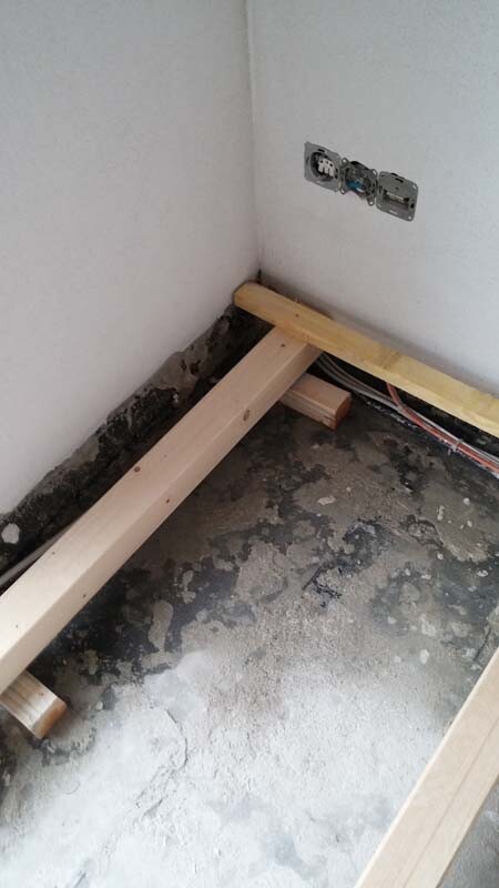

Exactly one year ago, we were in the same situation. For us, it was sometimes even worse... constantly forming damp spots in the corners (top and bottom) and also quite severely around the roof window. I was worried back then as well. I kept wiping the moisture off the corners with a cloth and ventilated regularly. This helped a lot, and the situation gradually improved. I always kept a hygrometer nearby to monitor the humidity. We have been living here since June, and now there is no more dampness in the corners or around the roof window.
The plaster and screed were applied in November.
On February 22, it still looked like this (see pictures).
At the end of April, the floorboards were finally installed.
Fortunately, we were not under any time pressure.
Best regards, Steffi.
