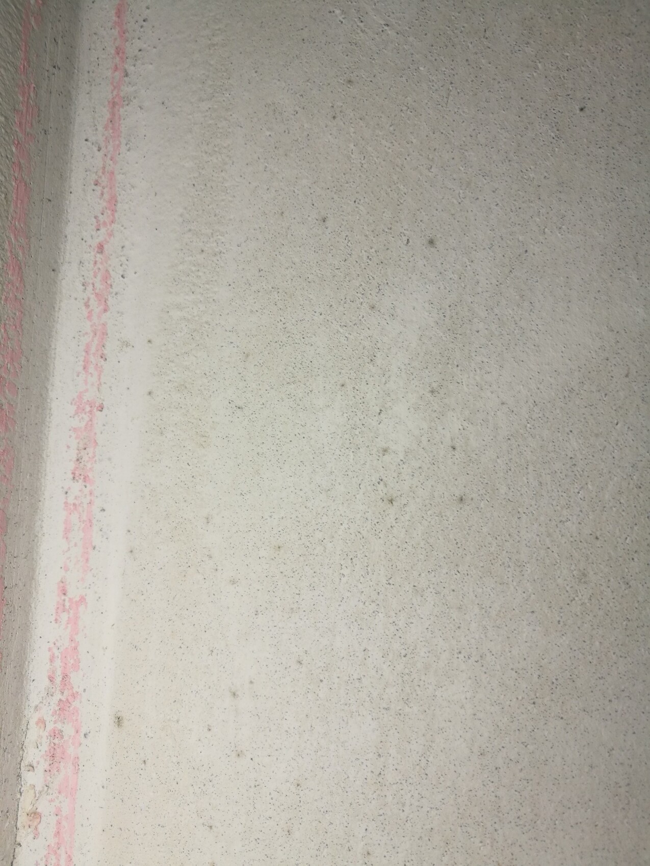

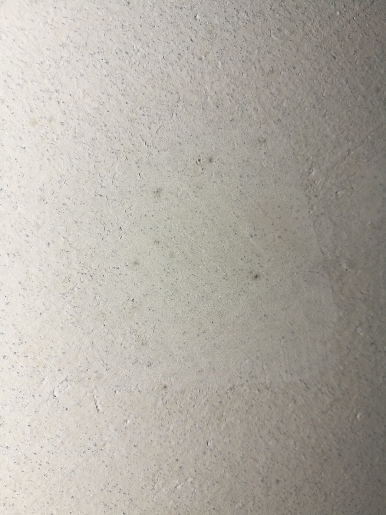

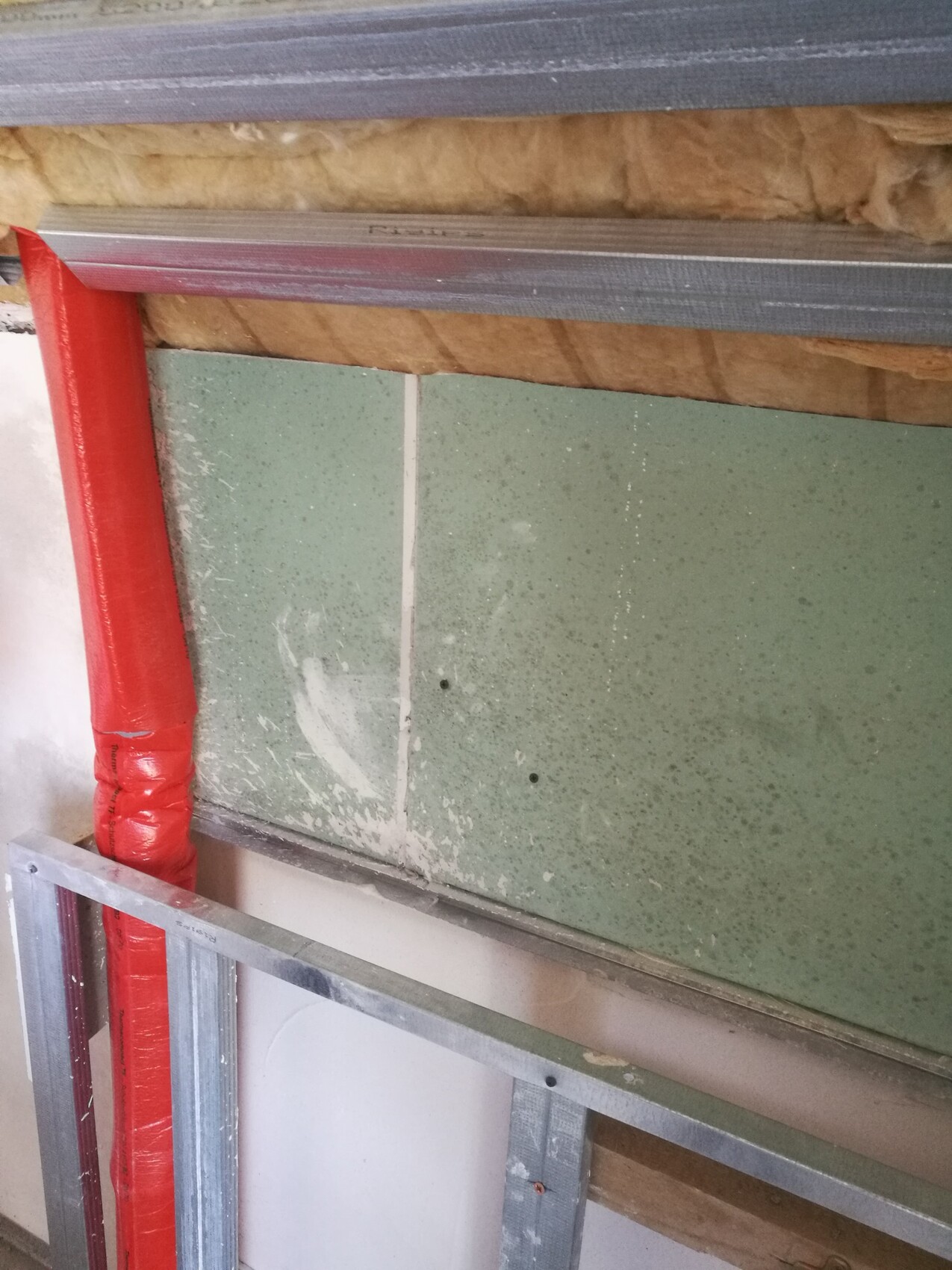

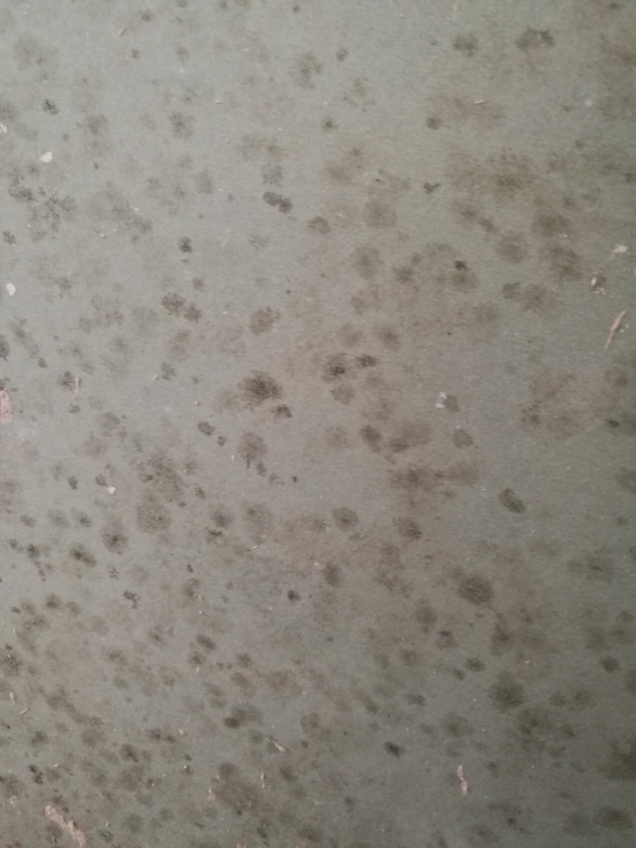

Ah, something I just remembered: because nothing happened for such a long time and the heating wasn’t working properly, small mold spots developed on the drywall panels in the bathroom.
Even now, the mold is visible through the plaster.
Once where the bathtub is supposed to go and next to it.
I have brought this to the site manager’s attention several times. When the drywall installers “installed” the bathtub, they simply hung a second drywall panel over the moldy one.
I have photos of everything.
According to the site manager and drywall installers, the moldy panel was treated with something so that it supposedly won’t occur again.
What do you think?
And currently, next to the bathtub, it looks like this (in the meantime, the painters have plastered over it again).
What do you think?
