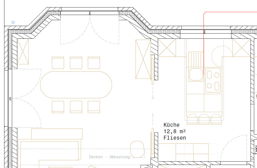

After the insolvency of our general contractor and extensive defect rectification, we are slowly starting to plan again in all directions (the shell construction has already begun). Unfortunately, the budget has become tight, and we need to see if we can maintain our plans. One of many (costly) considerations is:
Can we manage with a ceiling-mounted cooker hood? (Recirculation or vented option is still open)
- The kitchen is separated from the living/dining area by a 1.76m (5 ft 9 in) double sliding door
- Ceiling height is 2.51m (8 ft 3 in)
- The kitchen countertop will be around 90cm (35 inches) high
- A soffit of about 30cm (12 inches) height is planned below the ceiling
- The cooking station is (more or less) in the middle of the room
The cooker hood would therefore need to cover about 1.30m (4 ft 3 in).
Could you give me advice on whether this reliably works at all and, if possible, if there are any "affordable" devices suitable for this? (We probably won't be able to see the kitchen designer for a few more weeks)

If the marked area is the kitchen layout, you might want to optimize it first. Moving all the way around the peninsula to go from the prep area to the cooking area or to drain something is inconvenient.
And if by ceiling panel you mean a ceiling-mounted range hood... practical options generally start at around 1000 euros. A good recommendation is always Novy. I’ve had one for 6.5 years and am very satisfied. It works well and is quiet.

I agree with kbt: The kitchen layout is quite “unusual”...The layout is not up for debate. We have already discussed it extensively in various forums. It has been tested in kitchen showrooms and deemed “good.” The discussion here is solely about the height and type of possible range hoods and affordable options that (still) work.
kbt09 schrieb:
If that’s the kitchen plan you’ve drawn, you might want to optimize it first. Going all around the peninsula to move from the prep area to the cooking area or to drain pots is inconvenient. If that were the case, I would agree with you. But it isn’t.
kbt09 schrieb:
And if you mean a ceiling-mounted recirculating range hood with a ceiling panel… realistically, prices start around 1000 euros. A good recommendation is always Novy. I’ve had one for 6.5 years and am very satisfied. Good and quiet.Yes, exactly – there will be a 30cm (12 inch) tall boxed enclosure under the ceiling to house the hood. This results in a distance of about 1.30m (4 feet 3 inches) between the cooktop and the hood. Thanks for the tip about Novy – I’ll look it up right away!
