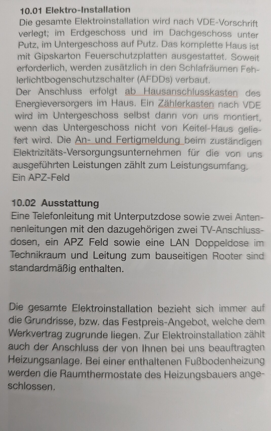

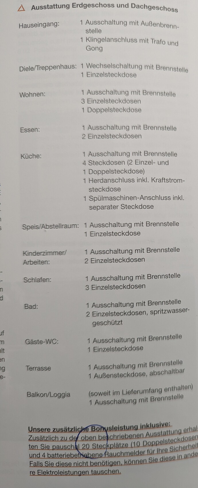

We received a quote from a home builder.
The electrical work is estimated at 16,500 euros.
According to the building specification, this includes the following:
Are the estimated costs in the quote realistic for this scope?
I’m asking because the builder offers the option to remove the electrical work from the contract and subcontract it separately.
Since we would like to have a KNX installation, we find this option interesting. However, it’s important for us to know whether we would have to expect significantly higher costs for the basic installation if we outsource it.

xMisterDx6 May 2022 21:56Wow. Is the contractor sure he wants to win you as a customer and not deliberately drive you away?
In my case, according to the installment in the construction contract, almost 10,000 EUR are budgeted for electrical work, and I have at least 2 to 3 more sockets in every room than in your offer. In the children’s room, only 2 single sockets? It’s common to have 2 single and 2 double sockets.
