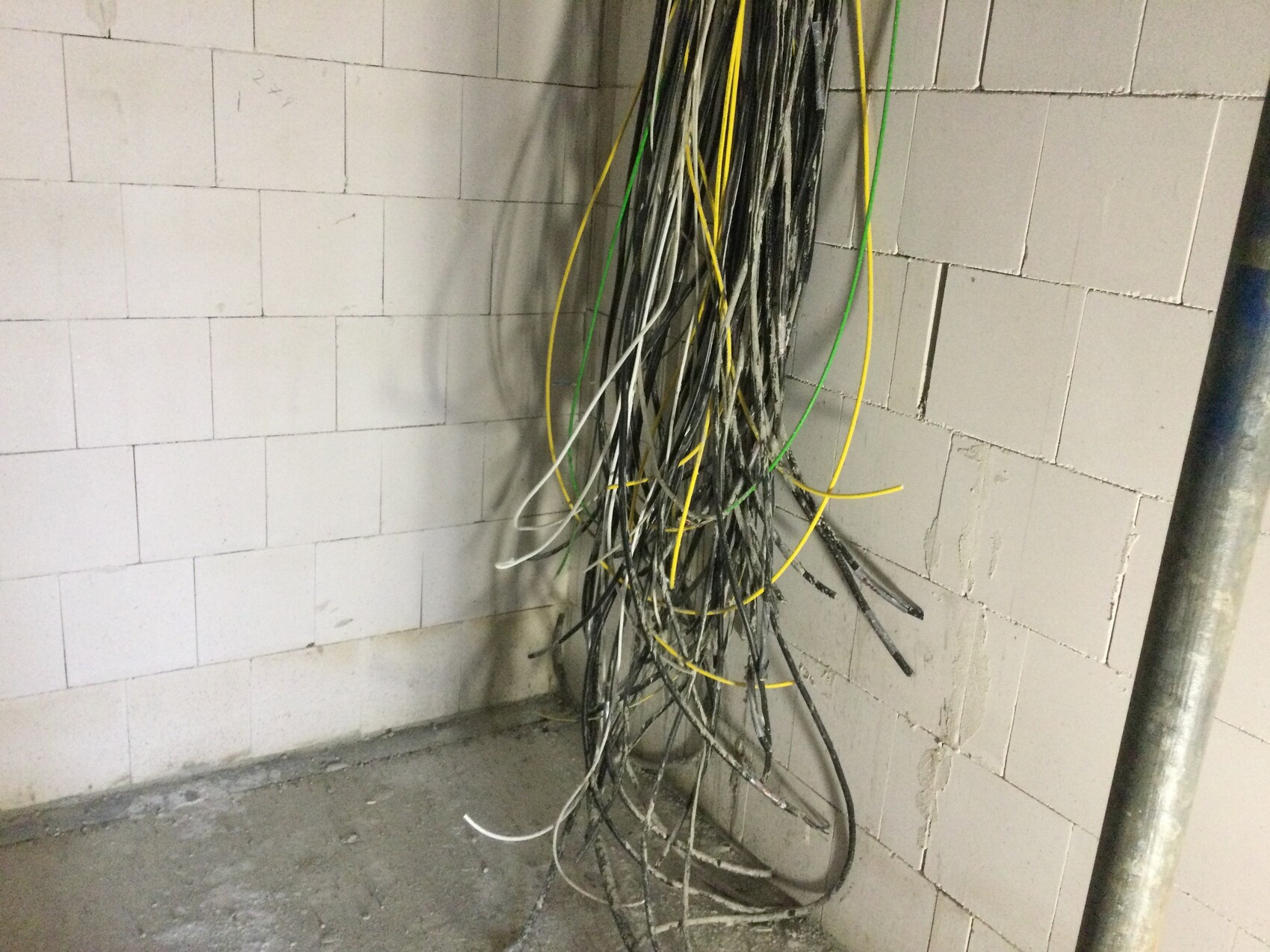

There will be a few more cables involved.
