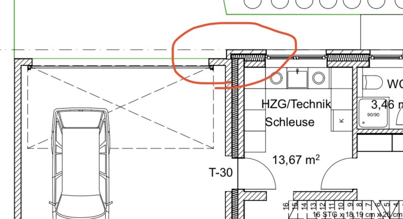

Our solid brick house is being built using a cavity wall construction and will be plastered on the outside (wall structure from inside to outside: 17.5cm (7 inches) Poroton brick, 18cm (7 inches) mineral wool insulation, 11.5cm (4.5 inches) Poroton brick). On the street side, the garage is set back by 25cm (10 inches).

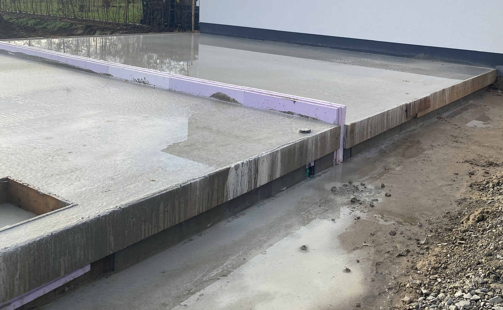

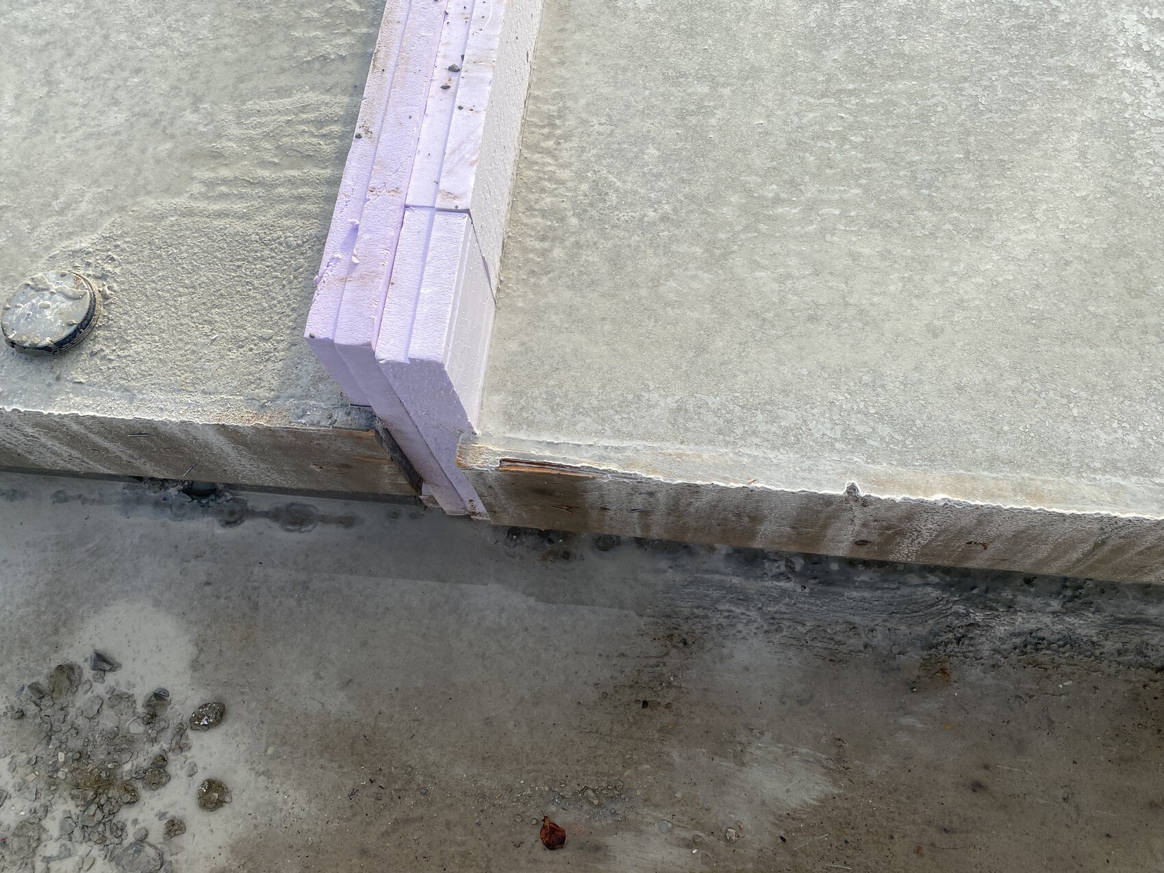

However, the garage’s concrete slab extends slightly further forward than the house’s slab. To me, it looks like the slab is aligned with the load-bearing walls. That would make sense, but the facing wall also has to be built on the slab and cannot be “floating” in the air, right?!
Am I missing something here?
I’ve attached a drawing and a photo of the construction.

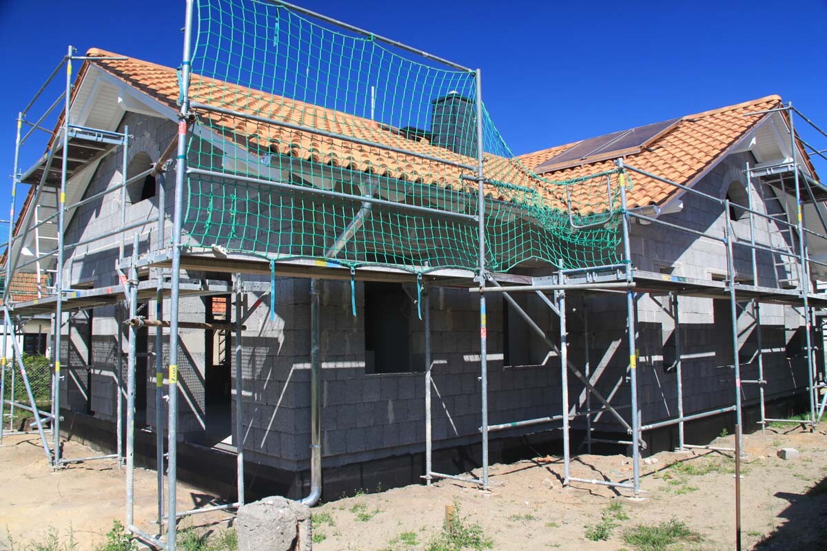

I’m not sure if I understood your problem correctly. I just remember that when we laid our foundation slab, I thought it was too small. It was missing several centimeters around the edges. After measuring, I had a sleepless night. However, it turned out that the first row of bricks around the perimeter was built with an overhang of about 5 cm (2 inches). This made the room dimensions correct again and everything was fine. You can see this in the picture… I hope so...

xMisterDx31 Dec 2022 11:03That wouldn’t work here because you can’t simply place the outer wall in the air or directly on gravel or sand.
