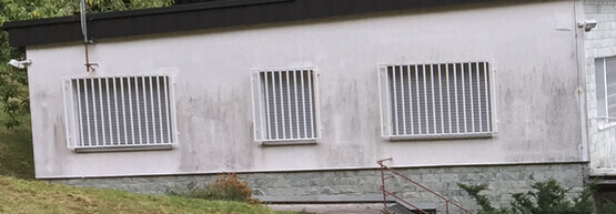

Hi everyone. I’m new here and quite inexperienced.
I’m wondering what those marks on the walls might be. Is it some kind of mold or just dirt? Is there an easy way to tell?
Thanks and good luck
Exterior view of a building with three windows, bars.

Good day,
This looks like classic algae growth on the rendered facade.
However, a building expert will know more about this!
Regards

If it is algae growth, would that be a more serious issue?
Thank you and good luck

No, the facade would need to be properly cleaned first and then treated (application of new protective coatings). The latter are sometimes already included in the paint. After that, the cleaned facade is painted.
Nofret30 Nov 2016 16:27
.. if you want to prevent algae growth, insulation and a larger roof overhang help.
