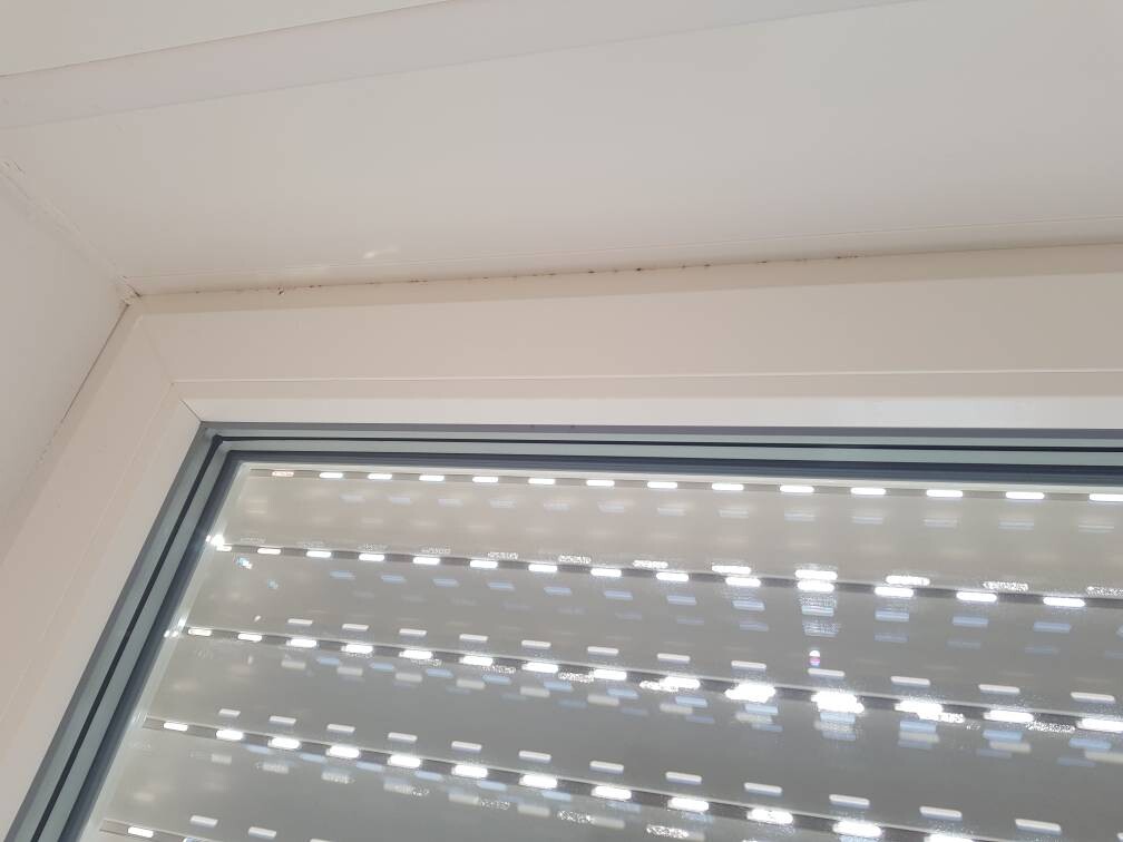

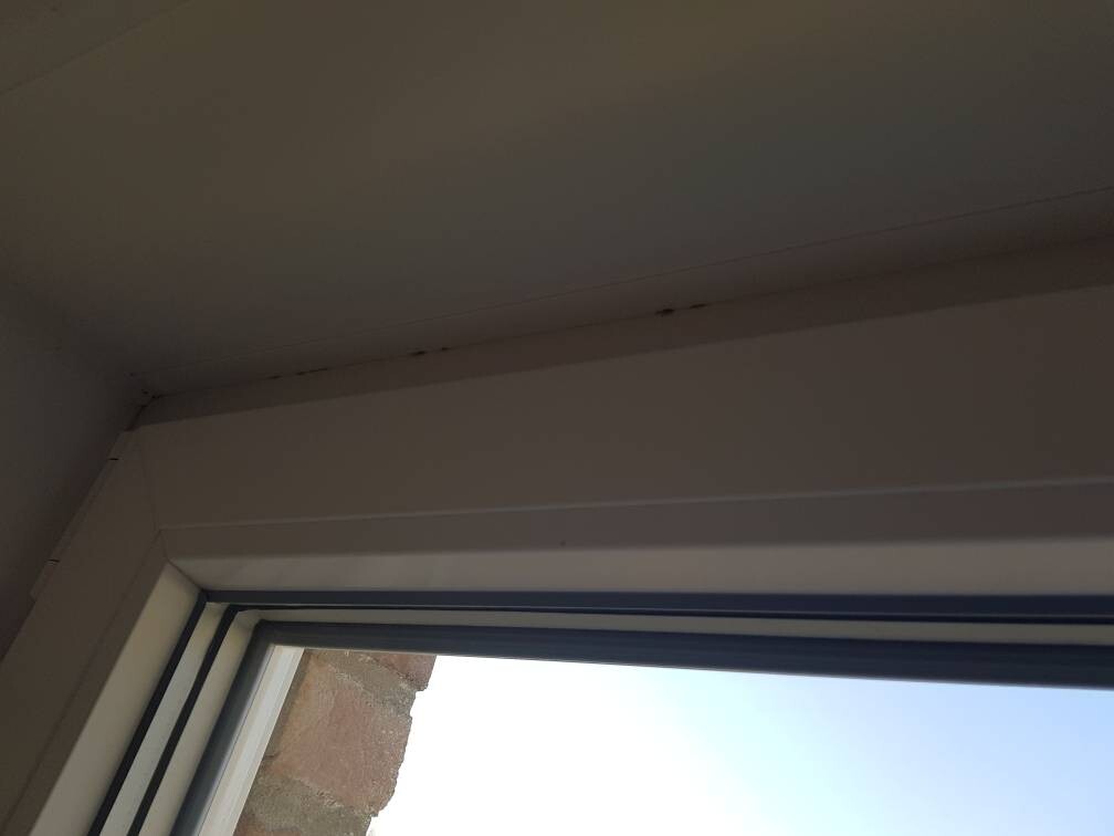

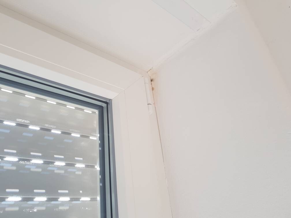

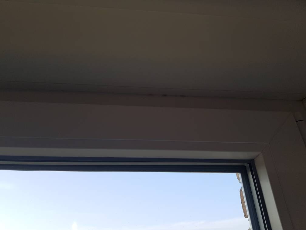

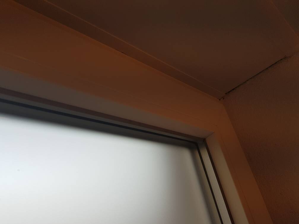

Yesterday, I noticed the following on the roller shutter box of three windows. Could this be mold?

It is hard to see clearly in the photos. But it almost looks like mold.
apokolok
19 Feb 2018 13:50
Looks like it.
Cold, uninsulated roller shutter box → warm air condenses on it → mold.
Since the affected area is very small and the cause is logical and easy to fix, I would say it’s not a major issue.

19 Feb 2018 14:45
Then they are poorly insulated or not installed professionally. In the third picture, you can clearly see the mold and condensation buildup. This is always assuming proper ventilation is maintained.
