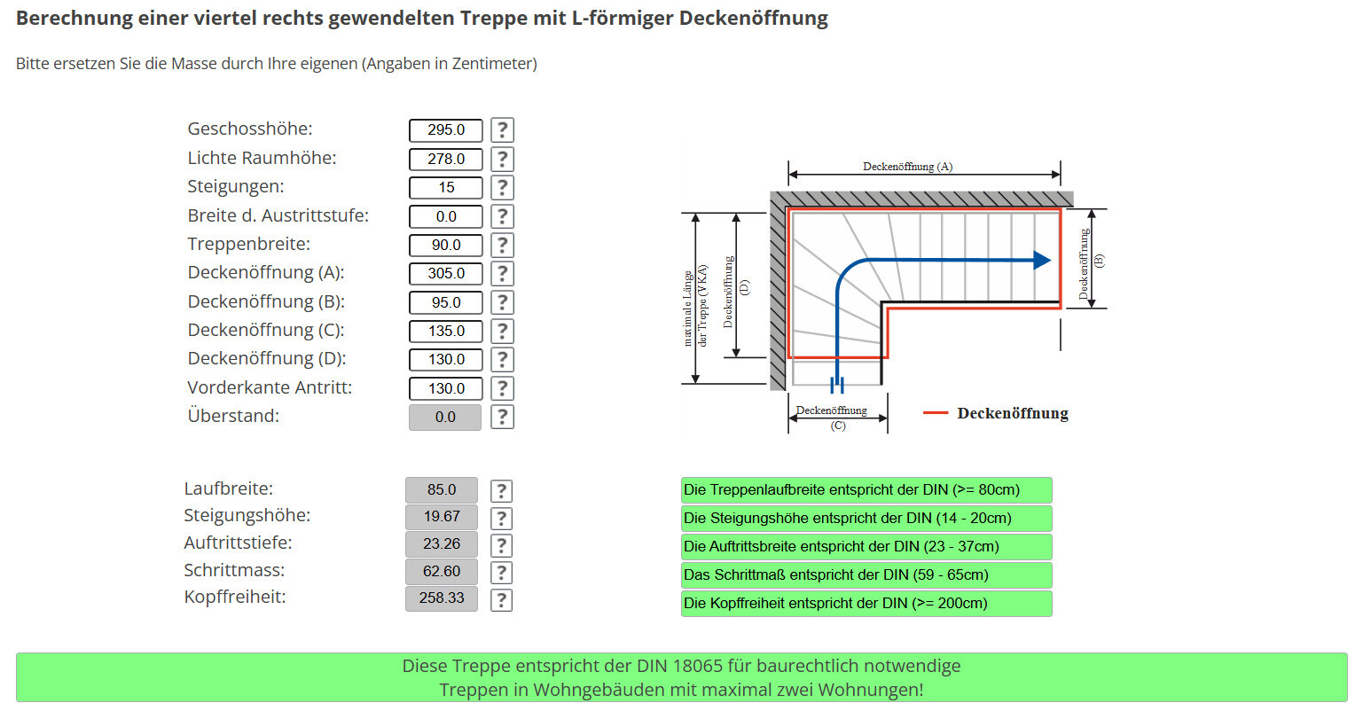

Well, if the length is limited to 250 cm (98 inches), then a quarter-turn staircase in the second direction will also require about 250 cm (98 inches). Here is the corresponding floor plan marked in red from post 16. Is there enough space in the other direction?
[ATTACH alt="1732031145242.png"]88892[/ATTACH] We planned it as shown in the picture.
Is this really the absolute minimum that the stair builder will construct for you "according to DIN" (German standard)?
As I mentioned before, I would never go below 3.60/3.70 meters (11 ft 10 in / 12 ft 2 in) for a straight flight. You could also say that the guideline of 19 cm (7.5 inches) rise and 26 cm (10.2 inches) going should not be underestimated. For open riser stairs, you might slightly go below that, since the toe has enough space without risers.
But well. The experience shared here should be clear enough for you. What you make of it, honestly, is your own responsibility.
I agree with @ypg, a tread depth of 23.26 cm (9.16 inches) instead of the 26.5 cm (10.43 inches) from my example, which is a difference of more than 3 cm (1.18 inches).
Also, I thought the stair length was limited to 250 cm (98.43 inches). Here, 305 cm (120.08 inches) is planned.
Timotheus19 Nov 2024 17:42ypg schrieb:
Is that really the absolute minimum the stair builder is making for you "according to DIN"?
As I said before, I would never go below 3.60/3.70 meters (11 ft 10 in / 12 ft 2 in) for the straight run. You could also say the guideline of a 19 cm (7.5 inch) rise and 26 cm (10 inch) tread should not be undercut. With open stairs, you might be able to go a bit lower since the tip of the foot has enough surface without risers.
But alright. The experiences shared here should be clear enough for you. What you do with that, honestly, is your decision. As I said... other stairs might feel more comfortable to walk on.
However, I prefer having 60–70 cm (24–28 inches) more living space if the DIN allows it.
