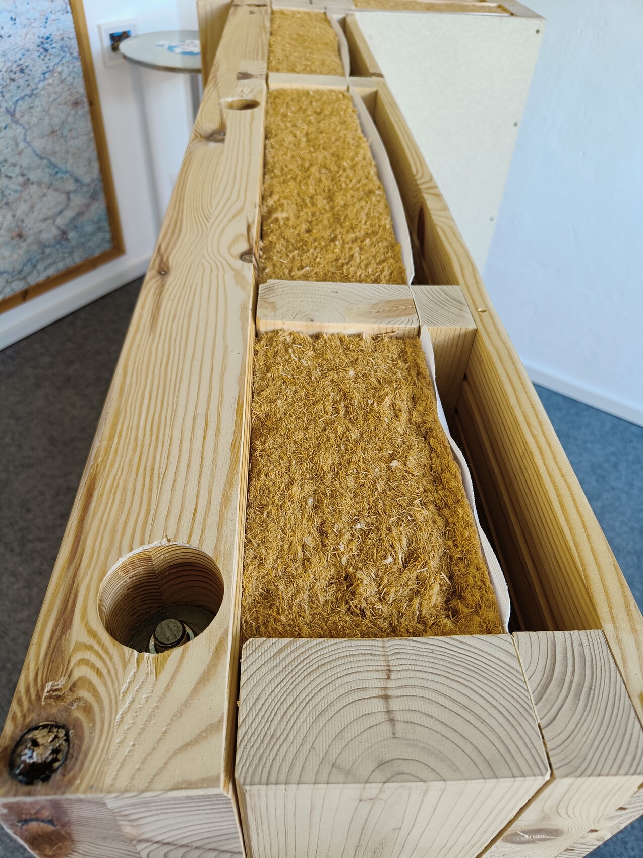

I am talking about a log house made of planks, from inside to outside: 10cm (4 inches) spruce / 20cm (8 inches) blown-in insulation / 5.8cm (2.3 inches) spruce.
Timotheus17 Nov 2024 15:59-LotteS- schrieb:
Please specify the exact wall construction.
I’m referring to a log house made of beams, from inside to outside: 10cm (4 inches) spruce / 20cm (8 inches) blown-in insulation / 5.8cm (2.3 inches) spruce. I took this photo on site.
