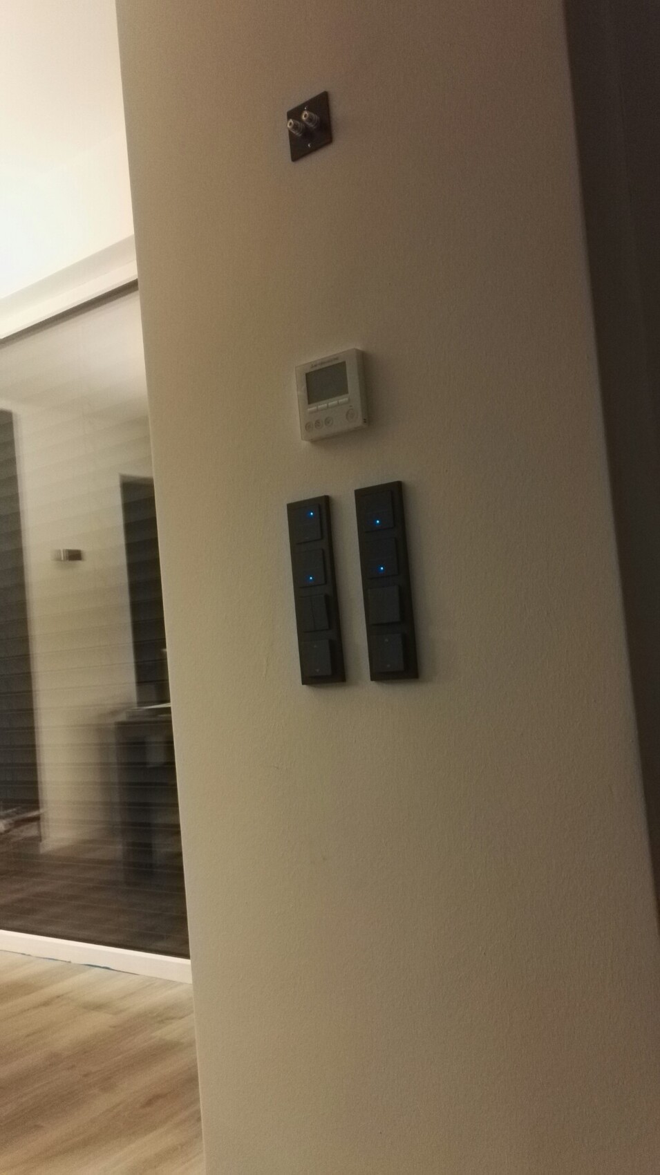

About the switches: Have you seen the new MDT switch for around 120 euros?
And to just go into the kitchen, you don’t need a switch. Not even one for operating it on the go. Generally, you don’t need a switch for the lighting, but in certain situations, of course, it can be nicely adjustable via the switches.
ONeill schrieb:
Regarding the push buttons: Have you seen the new MDT push button for around 120 euros? Looks nice, but it’s a pure glass push button without any tactile feedback, right? So it’s practically impossible to operate without looking?
The Berker BIQ looks quite nice and, from what I read, they are real rocker switches, meaning you can physically press and toggle them. But they can’t be labeled. So the Enertex MeTa remains. From what I understand, these are also real mechanical/tactile push buttons and not touch-sensitive. Plus, you can label them. But they’re in the 500 euro price range.
I know glass touch panels look sleek, but in daily use, a switch with tactile feedback is probably more “comfortable.”
And just to quickly go to the kitchen, you don’t need a push button. Also not one for operating while passing by. Generally, you don’t need a push button for the light, but in certain situations it’s nice to have it adjustable via push buttons. I do need a push button. If I let this run through a presence detector, the KNX forum recommends a delay time of at least 15 minutes. Then I see the kitchen light from the living room for 15 more minutes, and that will annoy me for 15 minutes. So I really need push buttons to turn the light on, complete the task, then turn the light off, and afterward, the programmed lighting works as intended.
The main problem is more the cost. Are there really people who only use KNX for lighting and blinds, and long-term completely skip window contacts, presence detectors, visualization, servers, ETS upgrades, weather stations, alarm system-like functions, cameras, doorbell integration, occasional new push buttons, heating, ventilation, voice control, etc.? I mean not just skipping one or two things but all of these? And in the end, this leads to an additional cost of 20,000–30,000 euros.
Another question, what are the “start-up” costs for KNX? Without automating anything yet, I’ll need at least:

If I understood correctly, your scenario with walking into the kitchen can be handled by the switches using the so-called “pat” function. Look that up.
Basically, I agree with you that a simple switch has become second nature not only to you but also to children (!!!) and your guests. There was a picture earlier in this thread of a silver/aluminum switch panel with no labels at all. What is that supposed to be? Nobody will get it without instructions. Four to six touch sensors and then trying to just turn on the lights? That’s no longer helpful; it’s a hassle.
But: nobody is forced to install that €550 item with multiple integrated touch sensors everywhere. You can also use normal toggle switches. Maybe you have more buttons in the living room, but in the children’s room just light on/off and blinds up/down. So, similar to a conventional wiring setup.
