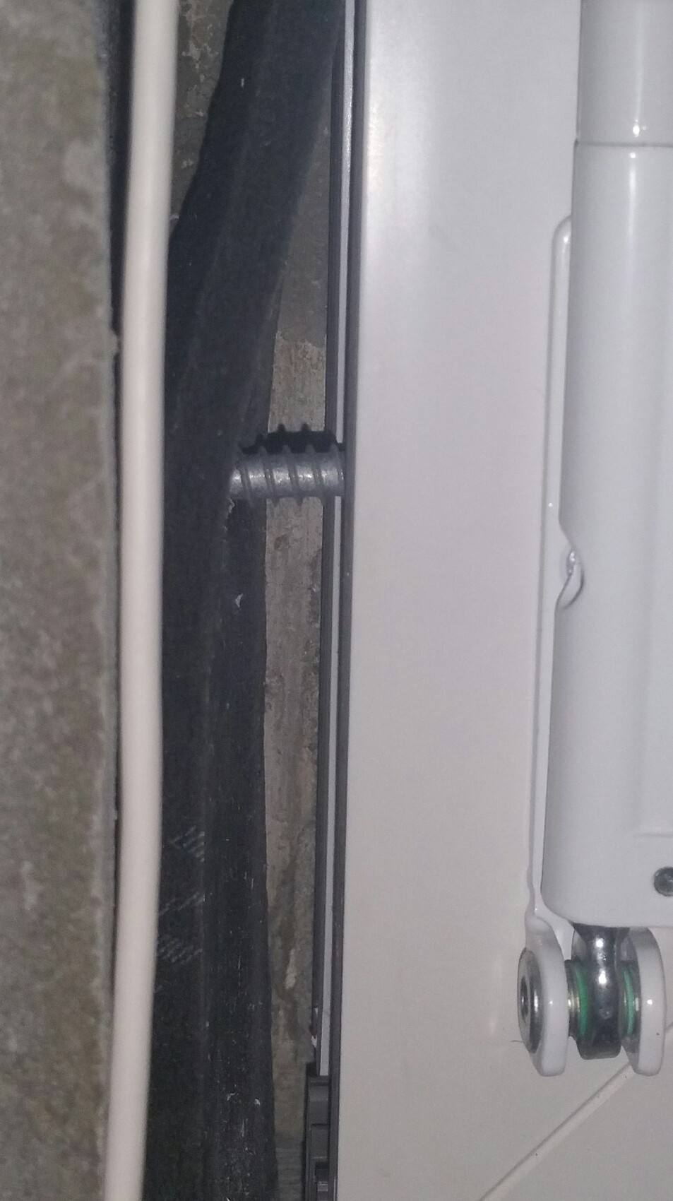

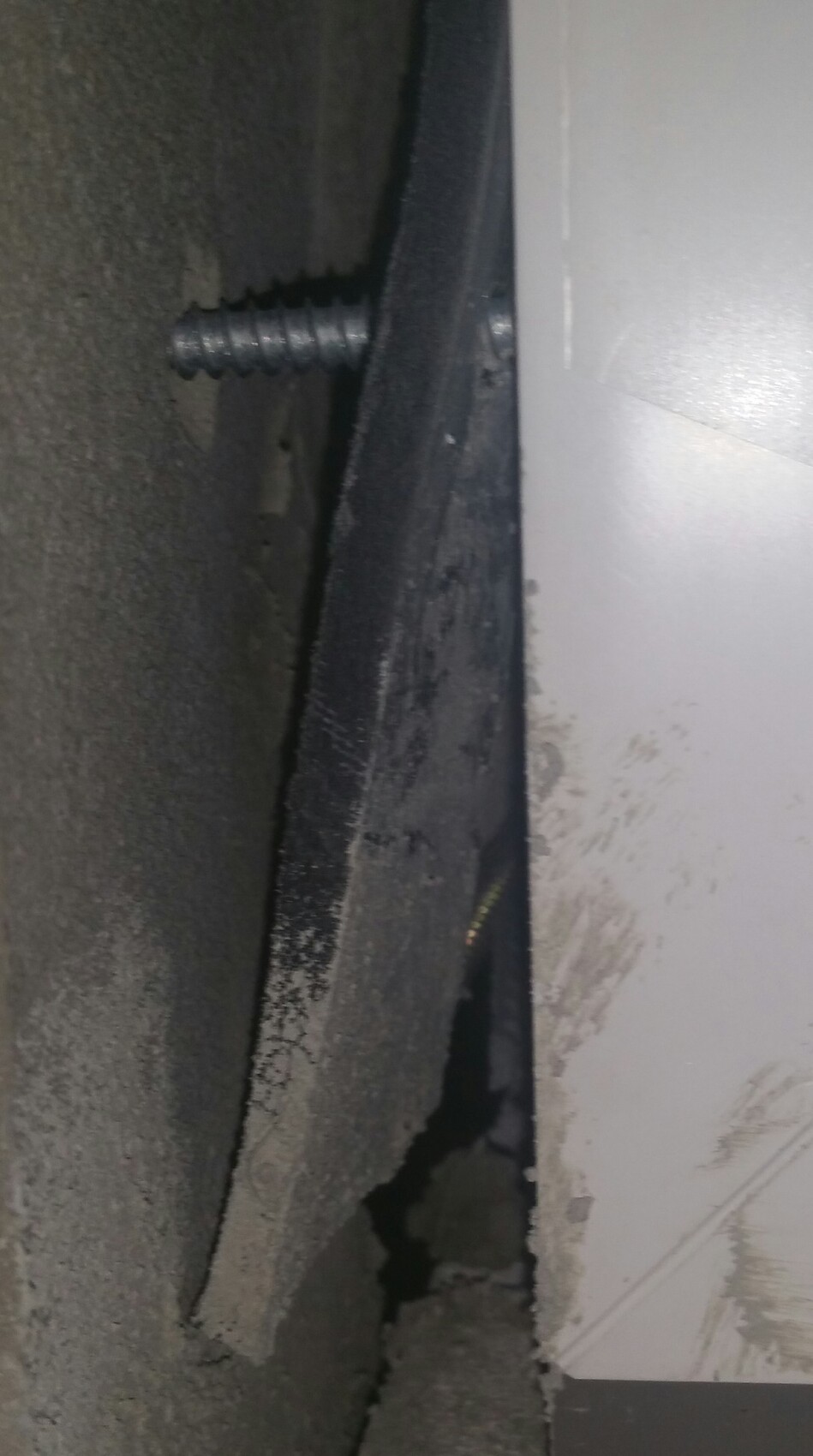

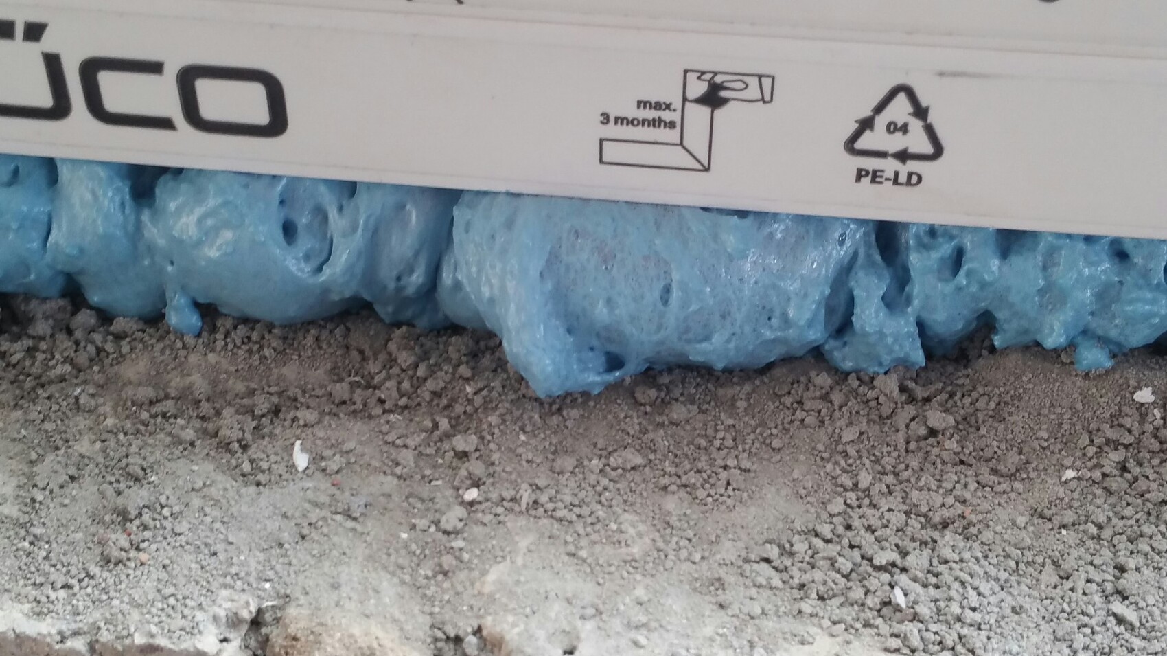

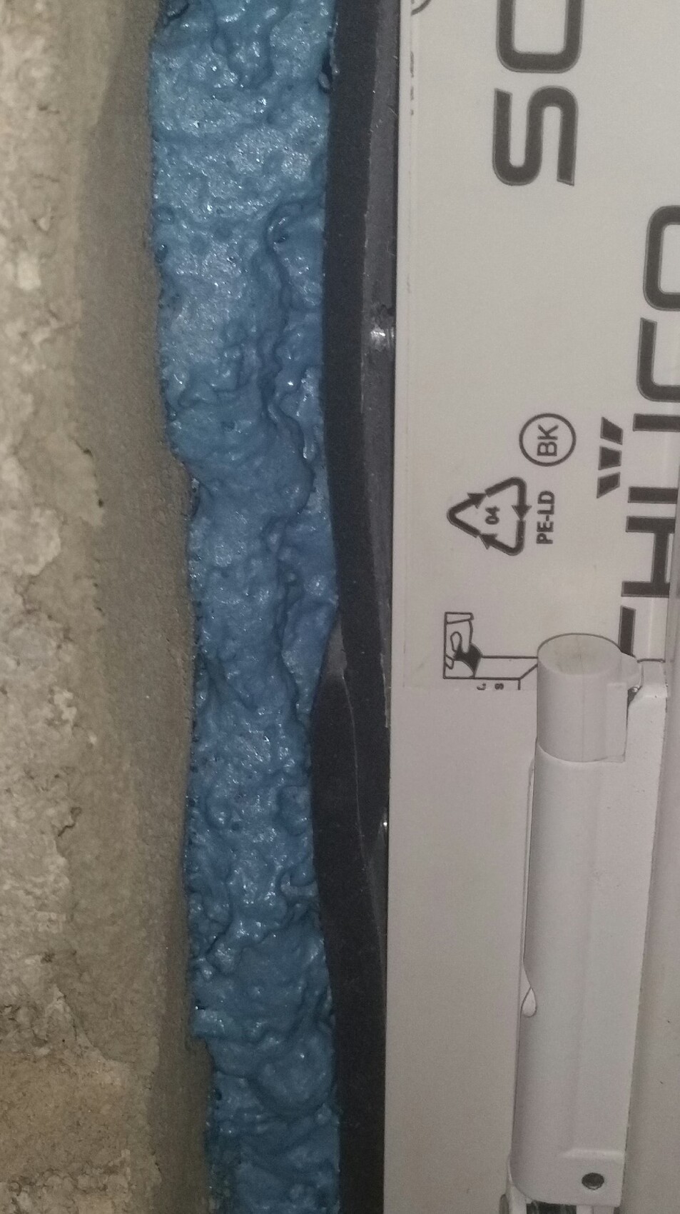

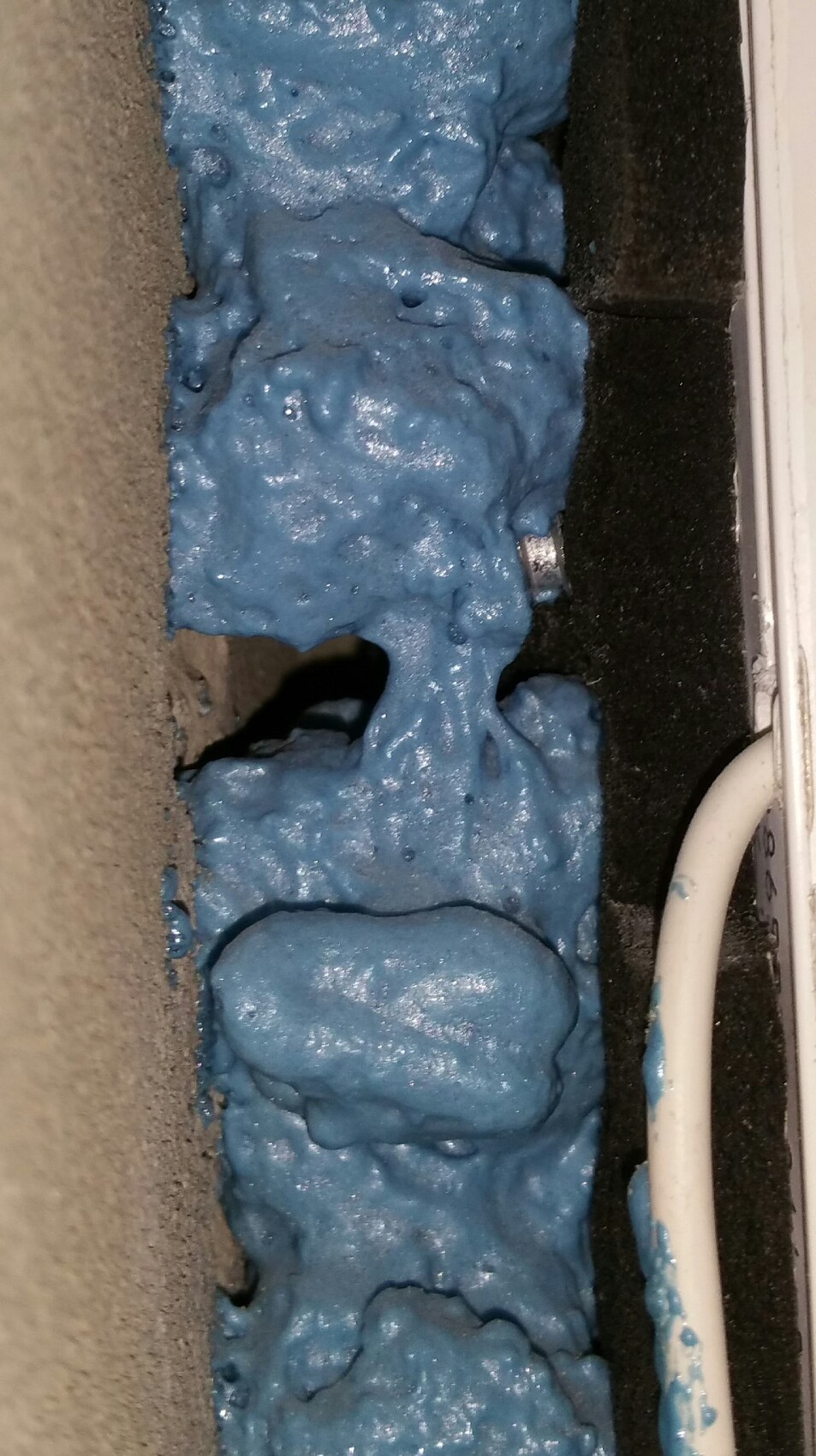

Alexthebest24 Mar 2018 08:18So, now I have to chime in as well. I’m new here and came across your post by chance. I’m a master carpenter and managing director of my own company, and I regularly install uPVC windows. It’s important to know that there are several ways to install a window according to RAL standards or current industry best practices. The photos you showed are simply a disaster. What was written about them is also not entirely correct.
First of all, the RAL installation method requires that the connection joint be tighter on the inside than on the outside. The exterior side of the window must be resistant to driving rain. In the installation you showed, a triple-layer tape from Illbruck or a comparable manufacturer was used. This tape combines all three layers in one: (driving rain resistant -> insulation -> vapor tight). The joint must not exceed the manufacturer’s specifications anywhere, otherwise airtightness cannot be guaranteed (1st defect). Additionally, foam was used for the reveal because the windows were clearly measured too small (2nd defect). However, foam does NOT provide vapor tightness. This means the window would not be sealed at all, even if the tape were properly applied everywhere (3rd defect).

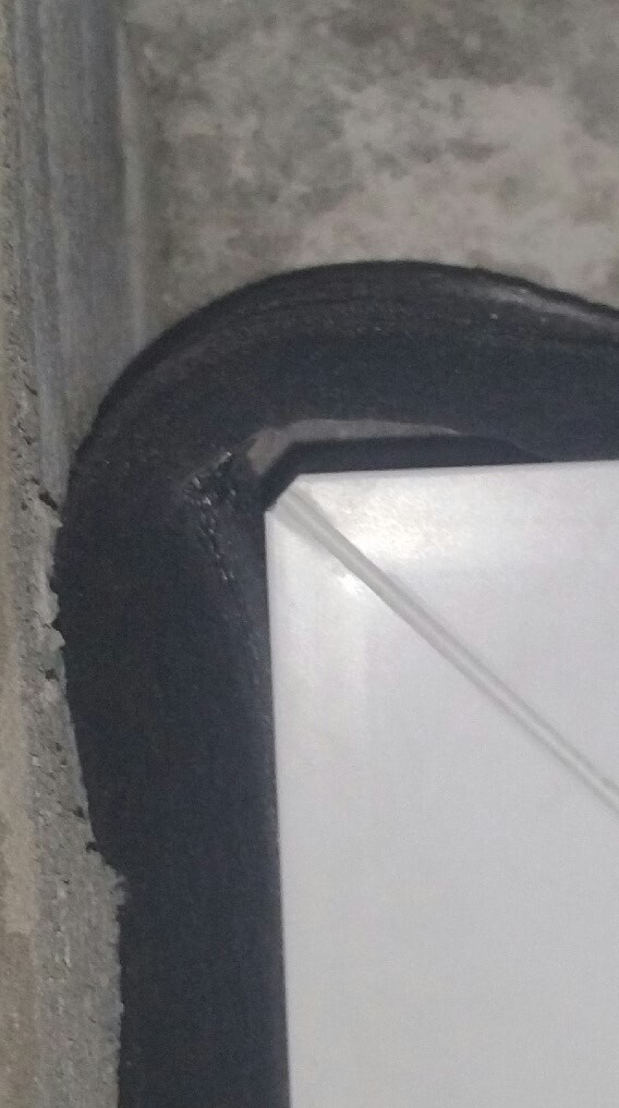

Furthermore, the tape was wrapped around the corners of the window frame. This should not be done because the tape cannot unfold correctly at these points. Instead, the tape must be cut and then overlapped with a slight extension on the other side to ensure a proper seal (4th defect).
Based on the photos, I can say that the windows will need to be completely removed and reinstalled fresh (and correctly). In my opinion, you don’t need an expert report for now, as these defects are MORE THAN OBVIOUS. Don’t let this get you down.
