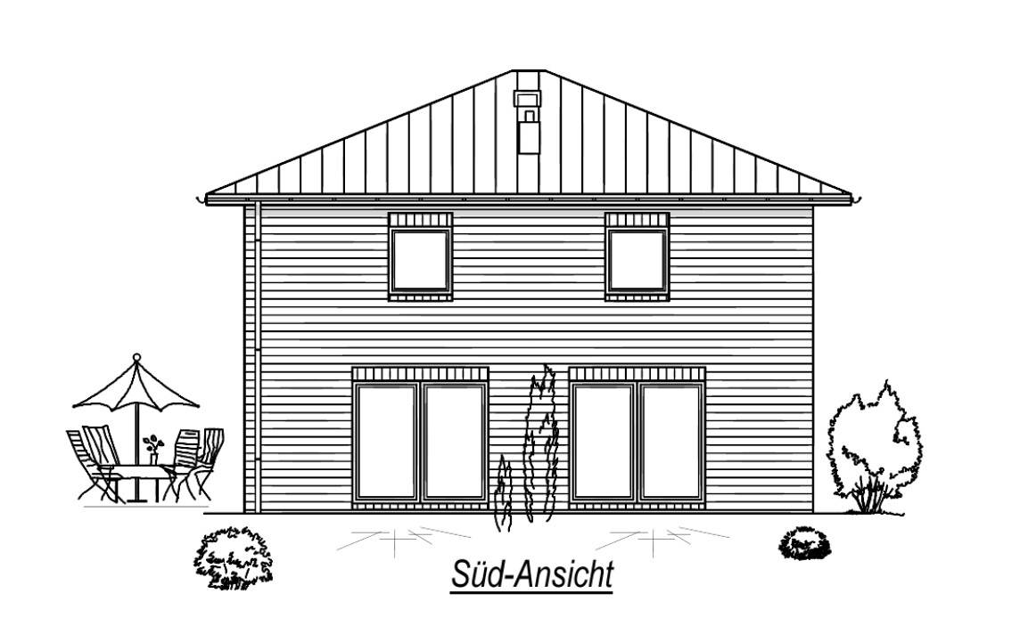

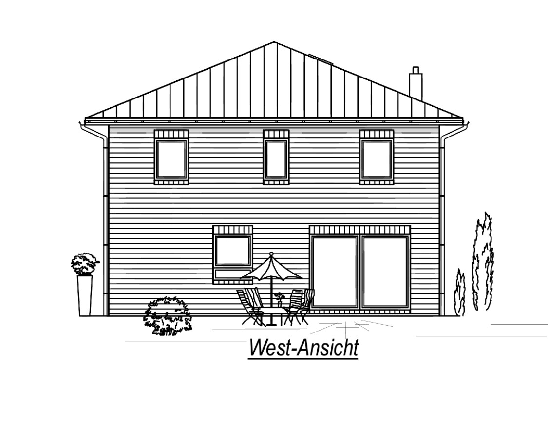

As the capacity of the inverter increases, so does its size. Our roof has a pitch of 22 degrees, no bay windows or dormers, just a chimney from a gas fireplace on the south side. I don’t know the exact roof area.
The orientation is southwest.

We have a roof pitch of 22 degrees, no dormers or bay windows, only a chimney for a gas fireplace on the south side. I don’t know how much roof area that is.
South-west orientation. The roof pitch is an advantage, so it’s probably worth considering installing panels on the north side as well. This needs to be calculated.
It’s a bit unfortunate that you have obstacles on the south side.
If the house hasn’t been built yet, I would ask if it’s possible to move the chimney to the north side.
Since it’s likely that all roof sides can be used, different inverter configurations are possible for you:

If the house is not yet built, I would ask whether the chimney could be moved to the north side.But the north side hardly gets any sunlight, so how could it still be worthwhile? Sorry for the silly questions, but I honestly hadn't considered this topic at all before.
The chimney can no longer be relocated, as it is a “shaft” for a gas fireplace and is positioned where the fireplace will be. On the north side, the chimney would run through the middle of the hallway on the upper floor.
Maybe I could have the roof hatch window moved to the east, so only the chimney would remain in its current place. The question is whether that would make a difference or not.
