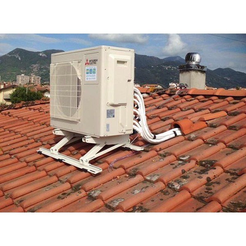

Absolutely no problem at all. The mounting bracket (adjustable at an angle) and all the other necessary parts are just a bit more expensive than the usual two wall brackets. Sounds good. But since the unit probably can’t be installed lying down, it might look a bit odd because with the low roof pitch, the unit might end up protruding above the roof ridge 😀. (Is that even allowed?)

Sounds good, but since the unit probably shouldn’t be installed lying down, it might look a bit odd because with such a low roof pitch, the unit might actually extend above the ridge 😀. (Is that even allowed?) It would look something like this:
Mycraft schrieb:
It would look roughly like this:
[ATTACH alt="tecnogas-roof-bracket-for-air-conditioning-units-800x480mm-made-of-stainless-steel-for-gable-roofs-11117.jpg"]71970[/ATTACH] Yes, exactly, only the moss clump in the lower right corner of the picture would probably be a bit further to the left in our case 😀.
