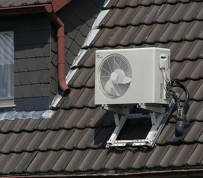

I looked up the weight of the outdoor unit; it’s under 50kg (110 lbs). Isn’t that a load that should be easily supported by a roof?
What I couldn’t find was the maximum pipe length. Does anyone here have a rough estimate? It would make it easier to figure out where else I could place the outdoor unit instead of on the roof... 50kg (110 lbs) should be manageable, but you definitely need to clarify this because the 50kg (110 lbs) also have to be securely mounted so that any potential wind loads can be withstood by the substructure.

I’m thinking of mounting the outdoor unit on the roof (any objections?). Can someone provide an estimate about that?Absolutely no problem. The mounting bracket (adjustable angle) and all necessary accessories are a bit more expensive than the usual two brackets for wall mounting, though.Nixwill2 schrieb:
