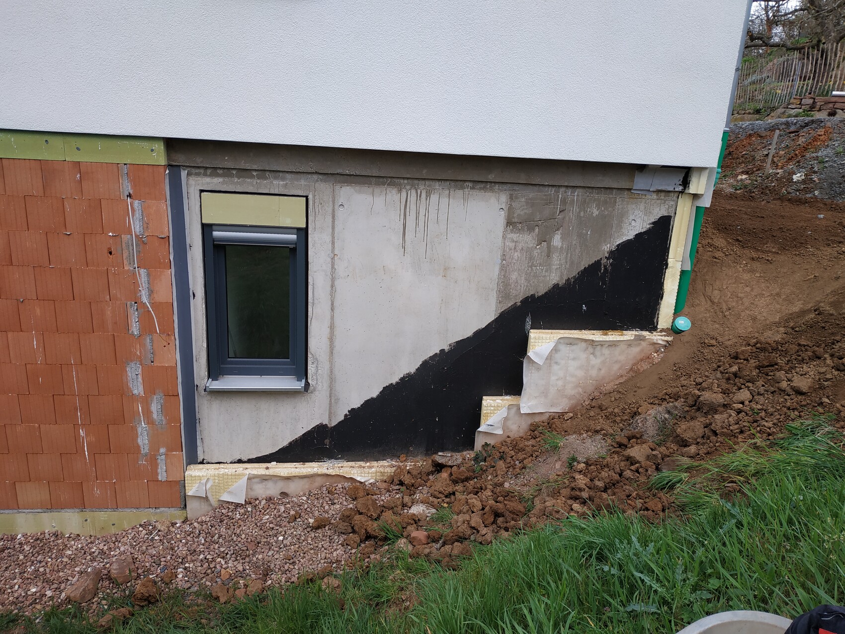

part of the basement wall on our house is still without insulation because we have not yet finalized the slope of the surrounding ground. It is now decided that a block step staircase will be installed roughly along the course of the bitumen waterproofing.
I wanted to finish the remaining wall with perimeter insulation and a fleece protection layer. However, due to the current building material situation, this is not possible; I can only get the same insulation without the fleece.
Do you see any problems here for the below-ground section regarding water drainage and the missing fleece?
Should I apply the bitumen coating over the rest of the basement wall (it is above the staircase and not below ground level)?

of course, it is generally recommended to use a membrane with fleece, but if you can’t get one at all, I would at least install a dimple membrane – these are also available with fleece.
Personally, I would have extended the bituminous waterproofing layer. Actually, you should apply a waterproofing layer at least 15 cm (6 inches) above the surface covering – however, this is not strictly mandatory.
