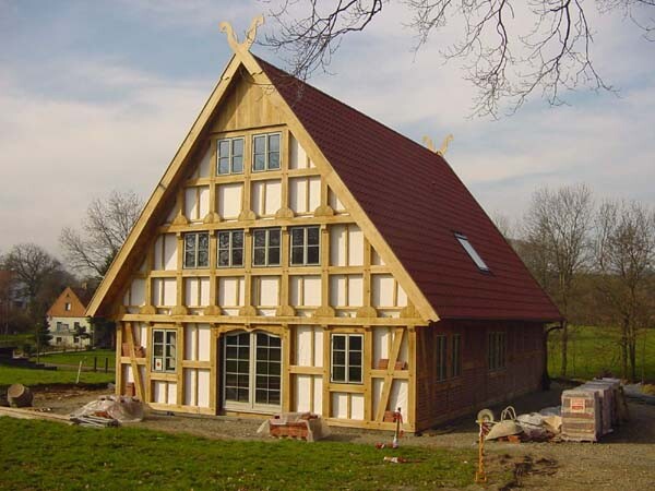

Basically, I would describe a new half-timbered house (FWH) as "nostalgic." Half-timbered construction was a structural expression of an era, built as efficiently as possible with the materials and construction methods available at that time. Today, a half-timbered house is no longer up-to-date; it also has numerous disadvantages: a high joint ratio in the facade, lack of wind and driving rain resistance, high demands on structural wood protection, etc. Additionally, the requirements of the energy-saving regulations for building insulation cannot be met with traditional half-timbered construction. Clay has a very poor thermal insulation value, comparable to concrete.
Providers of new half-timbered buildings can only construct the half-timbered structure as a cladding, possibly still load-bearing, in front of the actual house. Behind it is usually a ventilated and insulated masonry construction. For example, as seen in your photo, it is aerated concrete masonry without additional insulation and without a ventilation layer. The half-timbering is therefore purely decorative.
