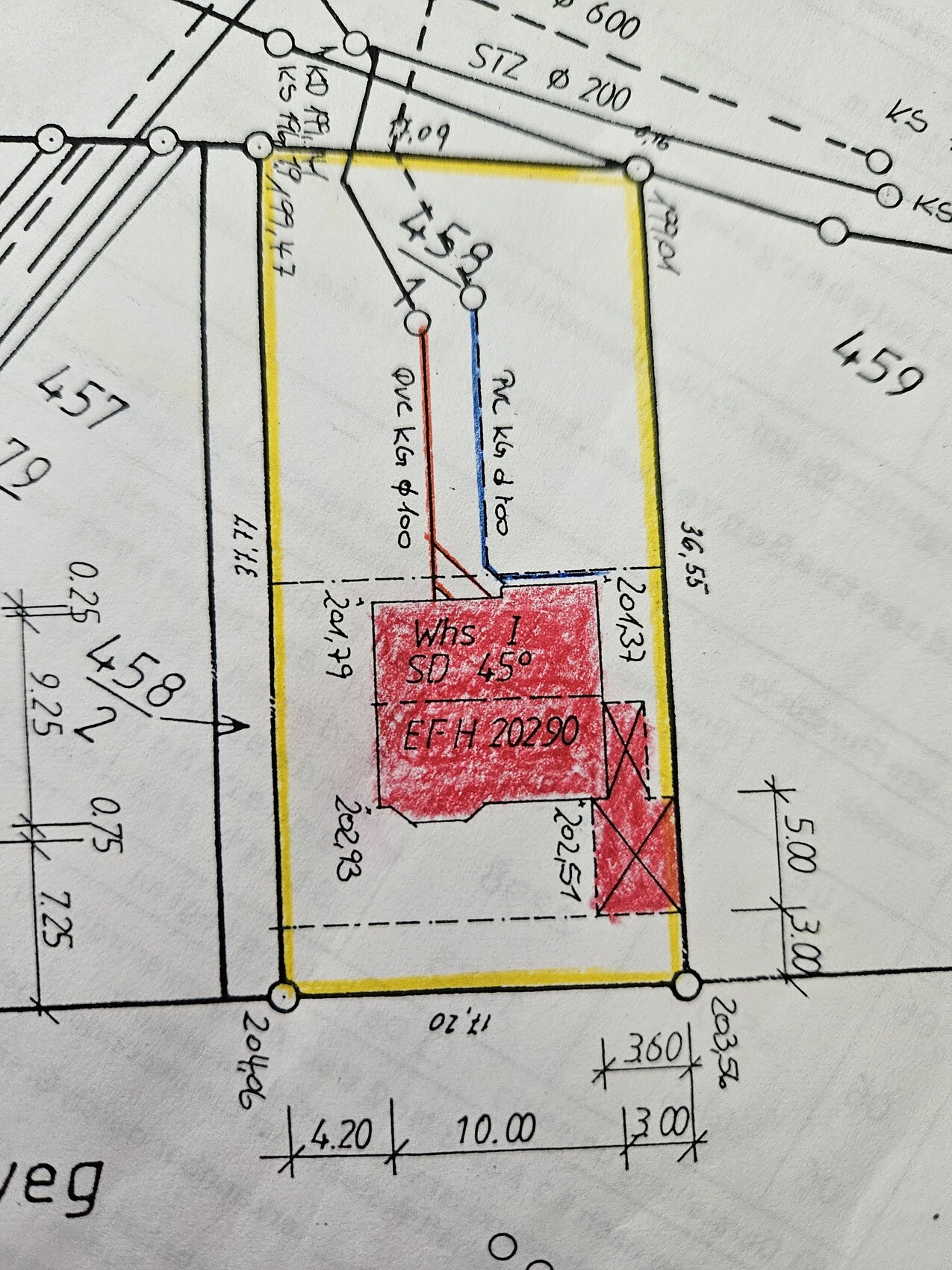

After 30 years, I would finally like to build a carport.
I would prefer to build it without a building permit/planning permission, but I think it might be too large for that since it needs to fit 2 cars.
In the old development plan from 30 years ago, a simple carport was already marked, but it was never built.
I now want to build my double carport similarly, but instead of 3.60m (12 feet) wide, it will be 6.00m (20 feet) wide.
Because of the roof overhang, it can only be about 4.75m (15.5 feet) deep, or I would need to move it 25cm (10 inches) closer to the street.
But I would be willing to take that risk myself.
Now to my questions:
I have to build the carport about 25cm (10 inches) away from the neighbor’s property line on one side because there is a wall between us, and I don’t want to place the carport on that wall.
- 1. So, the carport will be 5.00m (16.5 feet) deep along the property line on that side.
- 2. On the opposite side, the depth will logically also be 5.00m (16.5 feet). (Does this side count as a property boundary as well, since it is in the middle of my plot?)
- 3. The side facing the street will be 6.00m (20 feet) wide.
- 4. The back side of the carport will logically also be 6.00m (20 feet) wide. (Does this count as a boundary?)
According to what I found online, to be exempt from permitting in Lower Saxony, the built-up property boundary must not exceed 9.00m (30 feet) in depth and all other boundaries must total no more than 15m (50 feet).
So, if sides 2 and 3 count as boundaries, that would mean for all other boundaries: 6.00m + 5.00m + 6.00m = 17m (56 feet).
My question now is: do all four sides of the carport count as property boundaries (which would then mean 17m for “all other boundaries”)?
Or how should this be interpreted?
I would really appreciate an answer.

hanghaus2023 schrieb:
What does your architect say about the plan? They should be familiar with the local requirements.Which architect? This concerns an existing house.joshia01 schrieb:
They first check what kind of case it is, maybe dig out the old building application, etc. Do you really think they want to do you any favors?That’s silly and unprofessional. They have neither the interest nor the time to deal with old matters that are long settled.joshia01 schrieb:
It’s stated online when a carport is exempt from needing a building permit, but the question is how to interpret that.There is a lot of information online. Not all of it is accurate. Building regulations are not open to interpretation; they are clear.
The only point is that you have to apply them and not treat the building setback line as the property boundary.
According to your drawing, you intend to build 6 meters (20 feet) along the property boundary. That is possible.
