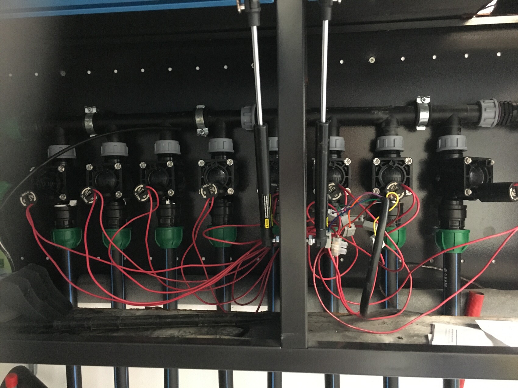

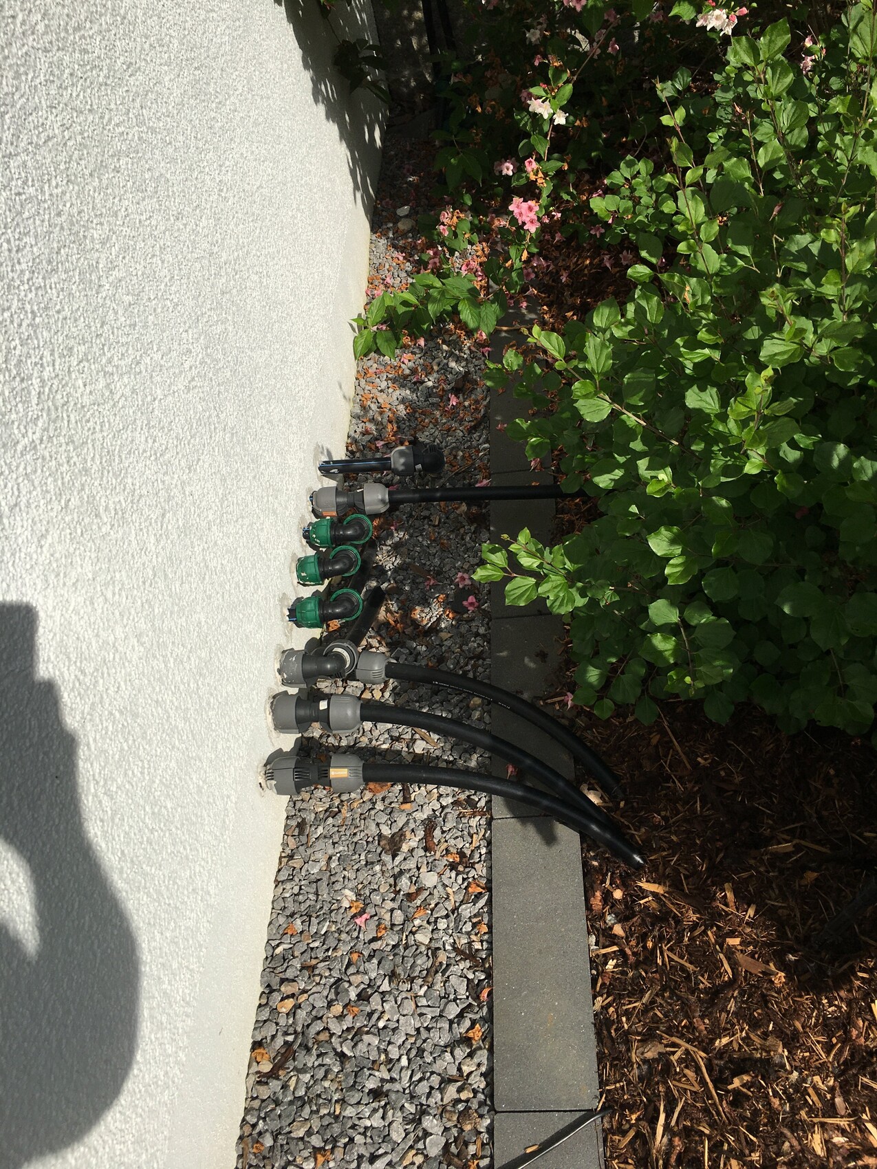

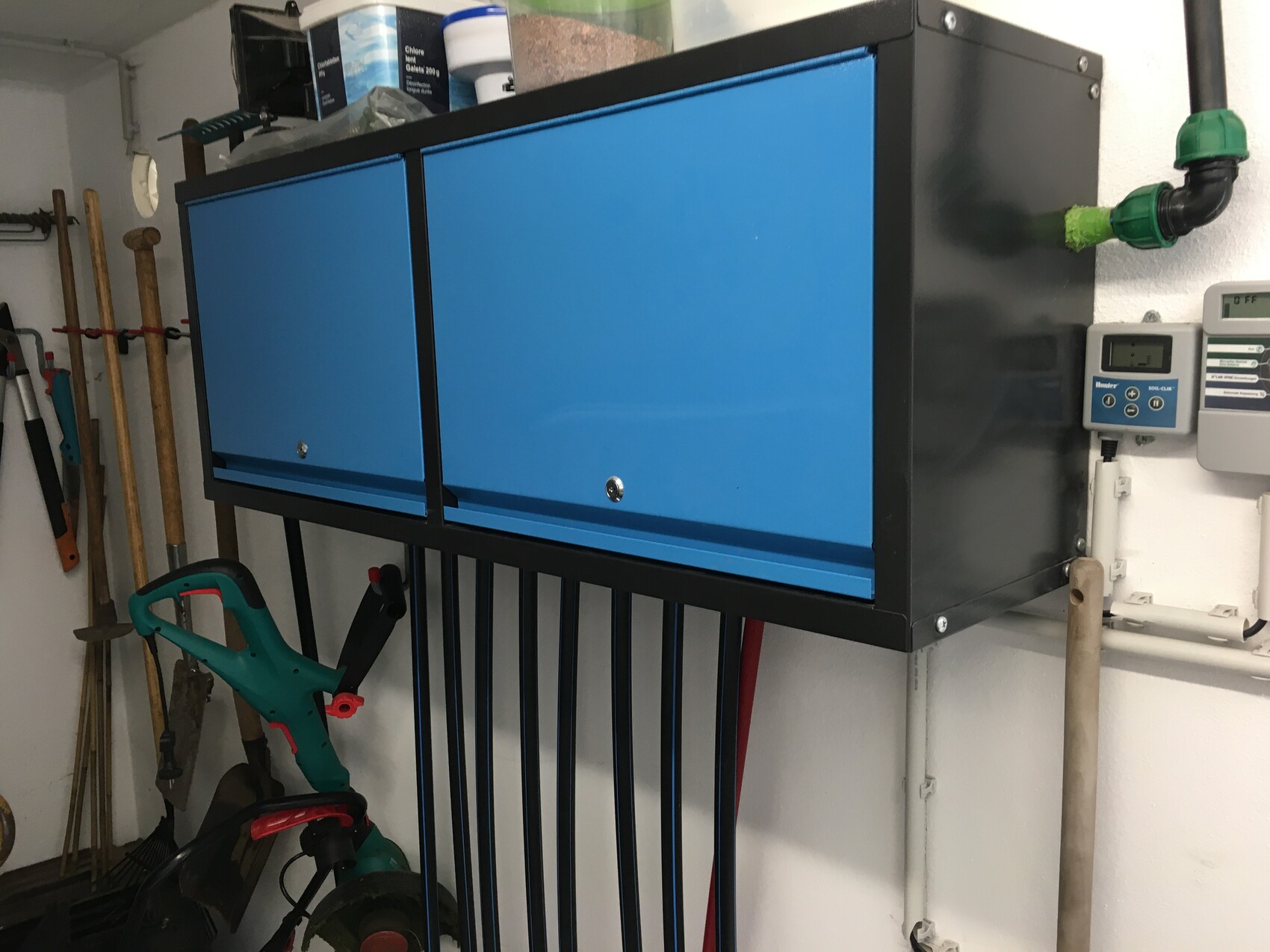

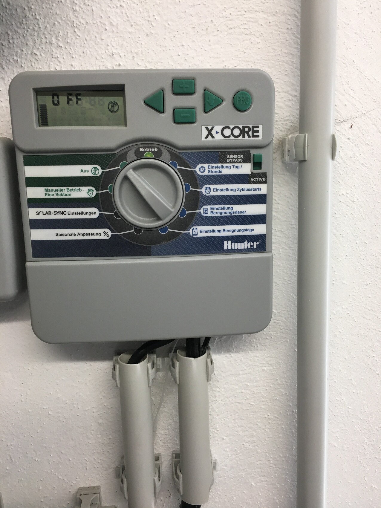

Our garden setup was a bit complex. We have four sprinklers connected to two irrigation lines (water tap with 5.5 bar pressure), plus two hedges—one in full sun and one in a shaded area—both watered via drip lines. There are also several pots on the patio irrigated by individual drip emitters, a vegetable bed with high water demand, and two long flower beds. In total, that makes eight irrigation zones.
The control system is set up as follows:
Everything is installed in the garage inside a tool cabinet, which I cut open at the bottom with an angle grinder. From there, eight lines run through the wall and branch out into the garden.
It is much easier to bury the irrigation lines before landscaping the garden than after it is finished. If you plan to expand significantly later, consider purchasing an irrigation controller with as many zones as possible. For sprinklers, I recommend Rain Bird impact sprinklers. Honestly, they look like cheap plastic, but they have excellent range and cover both close and distant areas evenly.
