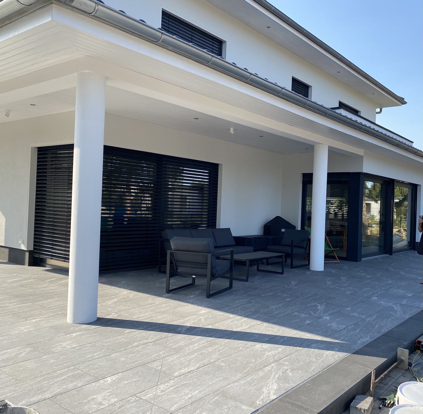

Good evening,
after extensive paving work and laying of stone slabs, we would like to fill the remaining small joints with a suitable material to minimize weed growth. We found online that there is a so-called "No Grow" joint filler sand that is supposed to prevent weeds from growing.
Therefore the question: Is something like this recommended? Has anyone here possibly had experience with it? Or are there better solutions?

Hutchinson1235 Aug 2022 05:26It is currently raining here: The material is permeable like sand or soil, so the water soaks in normally.
This should also apply to the material with the binder.

WilderSueden5 Aug 2022 10:09deezey schrieb:
Hello everyone, does this No Grow stuff also affect the infiltration properties? Does water now drain worse or not at all through the joints?For permeable pavers, gravel with grain size of 1-3mm (0.04-0.12 inches) is usually used; compared to that, drainage will definitely be much worse.Hutchinson123 schrieb:
As far as I know, Dansand No Grow is exactly that.
It doesn’t harden completely but is broom-stable.
There seems to be a stronger version with a binder. My experience with it is less positive. The material forms a crust that becomes unattractive after about 6 months. It never fully hardened for us. That’s why we switched to Sopro.
