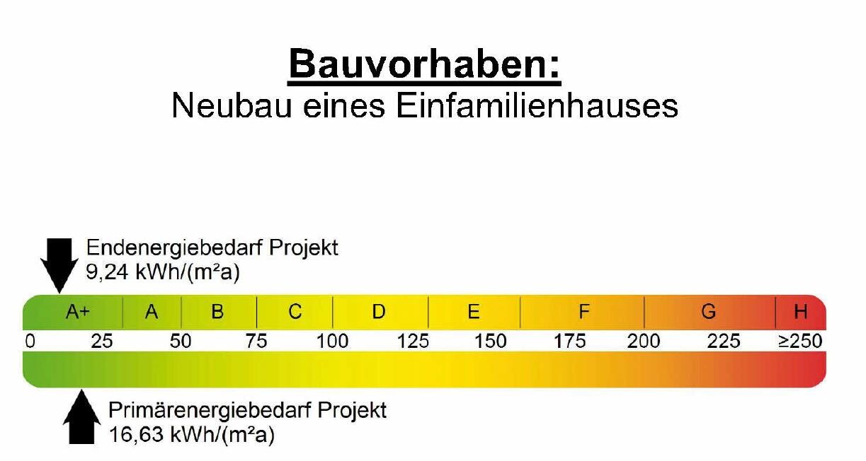

@Baumfachmann: What about you? Have you had bad experiences yourself or something? When you build to KfW55 standard or better, and add photovoltaic panels, why should the electricity costs be shocking?
For example, our house has a final energy demand as shown in the picture; the fireplace is not even included for the winter months. The photovoltaic system will approximately cover the annual electricity demand—of course, not simultaneously. So why should the expected electricity costs be such a big issue?
