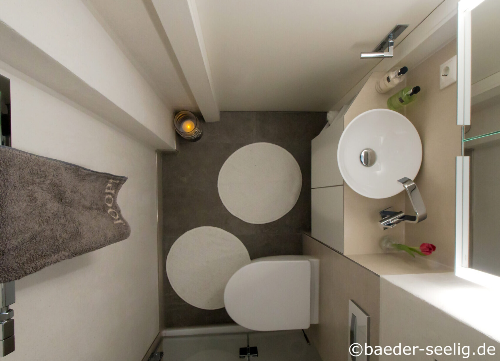

I would suggest a wall-hung installation similar to this, but with the new toilet rotated 45° into the corner and then mirrored:
Then everything can be concealed within the wall system. If you build it up high with a recessed cabinet, there’s space in the upper section for towels and more. Cover the wall with the washbasin entirely with mirrors to create a sense of more space — the toilet is positioned in the corner so you don’t see yourself in the mirror while using it. Add bright lighting or install a fake window with lighting on one side. Use large-format tiles or a resin floor and wall finish, and the whole bathroom suddenly has that “wow” factor.

I would suggest a drywall installation similar to this, but with the new toilet positioned at a 45° angle in the corner and then mirrored:
Then everything is hidden within the drywall frame; if you extend it high enough with built-in cabinets, you can also store towels and such in the upper section. Cover the wall behind the basin entirely with mirrors to make the space appear larger—the toilet is placed around the corner, so you don’t see yourself in the mirror while using it ;o) Add bright lighting or even a fake window with lighting on one side. Use large-format tiles or resin flooring on the floor and walls, and suddenly the entire bathroom has that “wow” effect.
