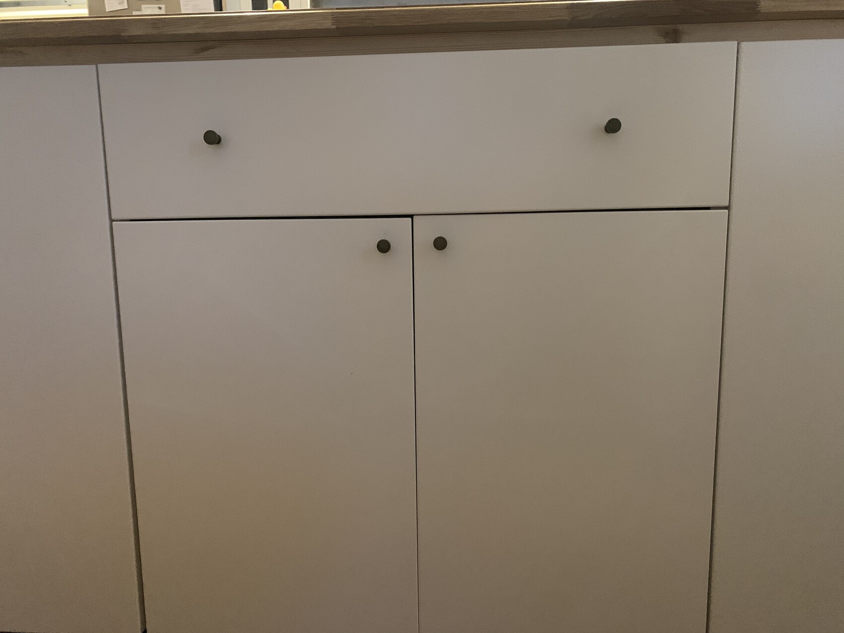

Schorsch_baut4 Oct 2024 06:31That works. We did that on the back side of the kitchen island.
Schorsch_baut4 Oct 2024 07:56kbt09 schrieb:
That is basically a base cabinet with reduced depth. If you search for "Metod base cabinets" on the Ikea website and filter the depth to 37cm (15 inches), they will show the suitable examples. I would prefer the wall cabinet because it has a top panel. Base cabinets only have rails.
Schorsch_baut schrieb:
Here is a photo for proof. My wife forbade me to take a picture of the inside of the cabinet.What surface do you have? Is that the Veddinge?Similar topics
