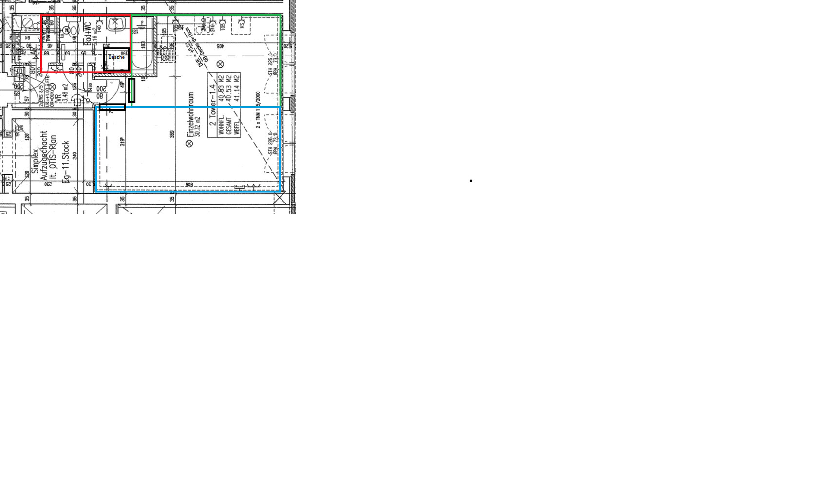

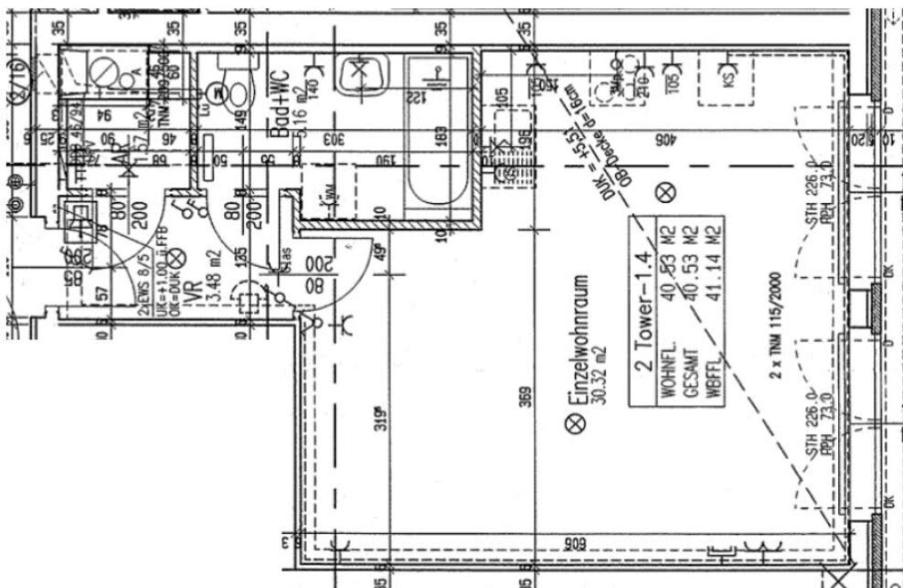

I am considering dividing my father’s apartment into two separate living units. The goal is to have one part available for personal use and to rent out the other part (for example, to a student, via Airbnb, etc.). Ideally, both units should have their own bathroom including a toilet and a small kitchenette. I understand that this will involve significant construction work, especially since the floor plan (see attachment) may not be ideal for this purpose. Primarily, I want to find out whether it is even feasible to separate the space in terms of structure and plumbing, and if so, how it could be done.

Gianni00712 Jul 2019 15:45But would it be possible to build the supply line one level higher so that the pipes run within a raised floor? It is “only” about 2 meters (if you run the pipes from the kitchen to the bathroom as shown in the drawing). Or would a sewage pump be necessary here?

As mentioned before... the possibility of reducing the size of the bathroom and moving the kitchen to the back (see image above) should be feasible, right?
