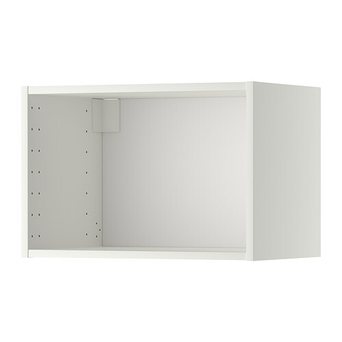

robi_aus_ffm8 Jun 2016 17:28I have the Besta cabinets in the living room and used this size as an overhead unit. Compared to the Metod cabinets, they are very lightweight.
If I needed something to sit on (I assume you will be adding cushions anyway), only the small Metod carcasses would be suitable. They are significantly more stable and heavier.
2x
For additional stability, place a 120cm (47 inch) panel on top.
You can also screw on different feet if you want.
Best regards, robi
