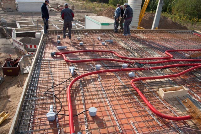

I still can’t imagine how recessed lights are installed in a concrete ceiling. That means there have to be holes in the concrete. And what about the cables? Exactly! The positions of the recessed lights are determined first, and then the ceiling, including the cables, is poured with concrete (either using traditional methods or with precast hollow-core slabs). As I said, this is common practice—no more suspended ceilings.
nordanney3 Mar 2016 12:37Well, you could also have a technical shaft and ventilation ducts on the unfinished floor... then you don’t need to lower the ceiling, and you can install ceiling outlets only if you don’t want anything on the walls or floor... although I don’t understand what the problem with that is.
