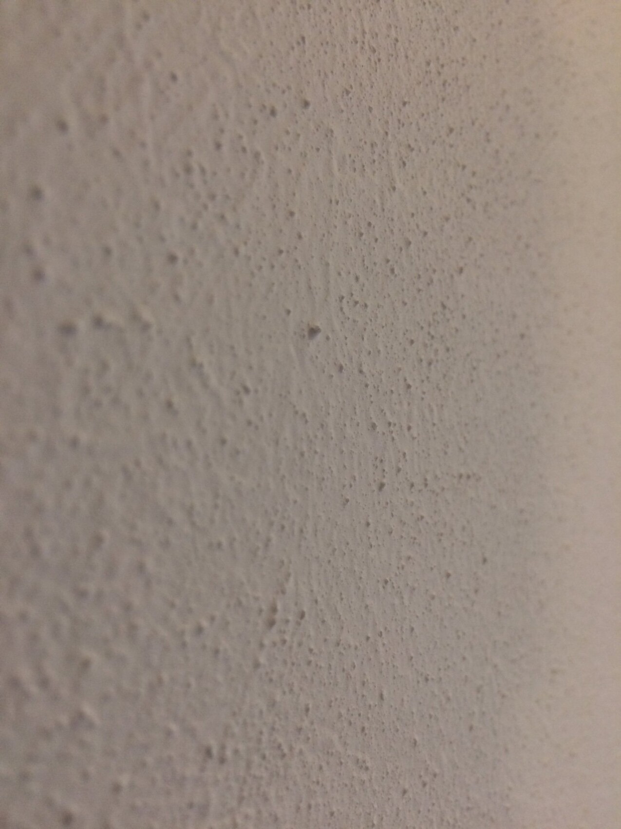

Nordlys schrieb:
We can live well with Sto Sil on Q2. Seriously, even our guests don’t notice anything negative. As I said, we didn’t just roll it on lightly; my brother went ahead with the lamb’s wool roller, applying it generously. I followed behind with a ceiling brush and wiped large semicircles into it. Since the material contains grains, it intentionally looks uneven. My brother says architects love this; they like to specify it, and then the painter charges a premium for a job that any experienced craftsman with an apprentice could do. Try it in the basement, and I’m telling you, it will catch on.I once mixed quartz sand into paint and applied it with a brush to texture the wall. Would that create a similar effect?
