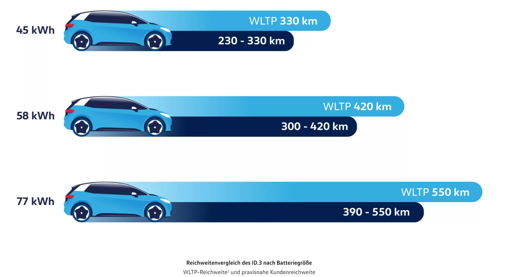

How far is the range of the ID3 mentioned here quite often?
nordanney
11 Aug 2020 12:20
Three bar charts showing ID.3 range by battery sizes (45/58/77 kWh) with WLTP 330/420/550 km.
