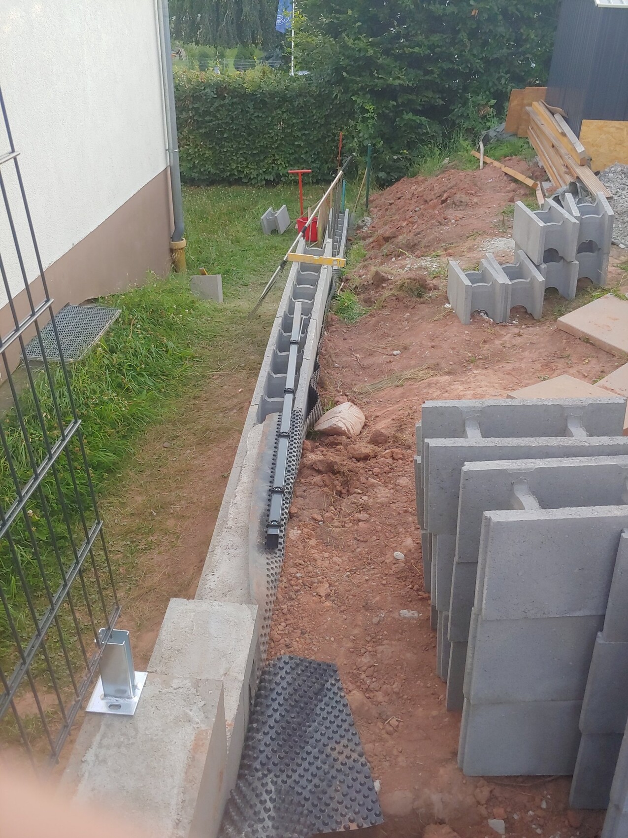

Attached is a picture... the wall is not complete yet, but the right side will be backfilled by us...

Strahleman6 Aug 2021 21:49Did you skip the strip foundation, or is it just not visible in the picture? Currently, the absence of a foundation concerns me more than the drainage over the clay soil.

@strahlemann: The foundation is, of course, in place (between 45 and 65 cm (18 and 26 inches)) and there is also compacted gravel underneath. We have also used plenty of steel reinforcement in the wall.
Nevertheless, we are unsure whether our construction method using clay and topsoil might eventually cause moisture problems in the wall.
