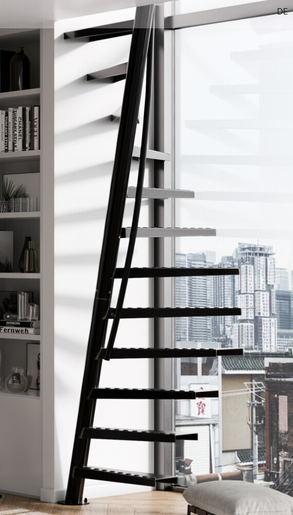

nordanney11 Jul 2024 11:23For a space-saving staircase, you need about 1 square meter (11 square feet) of space.
I would ideally place such a staircase, like the one in the photo, in the living room next to the fireplace. If you install it in the utility room, you might already be close to the edge of the house, making it difficult to exit the staircase at the top due to the sloping roof.
Keep in mind a building permit / planning permission if you want to create a proper living space.

MachsSelbst12 Jul 2024 22:37Forget it. Insulating the entire roof, installing heating, electrical work, windows, reinforcing the attic, cladding everything... That will cost more than buying a house that already offers the space you need. And one of those space-saving staircases. How are you supposed to carry more than a single book upstairs properly?
