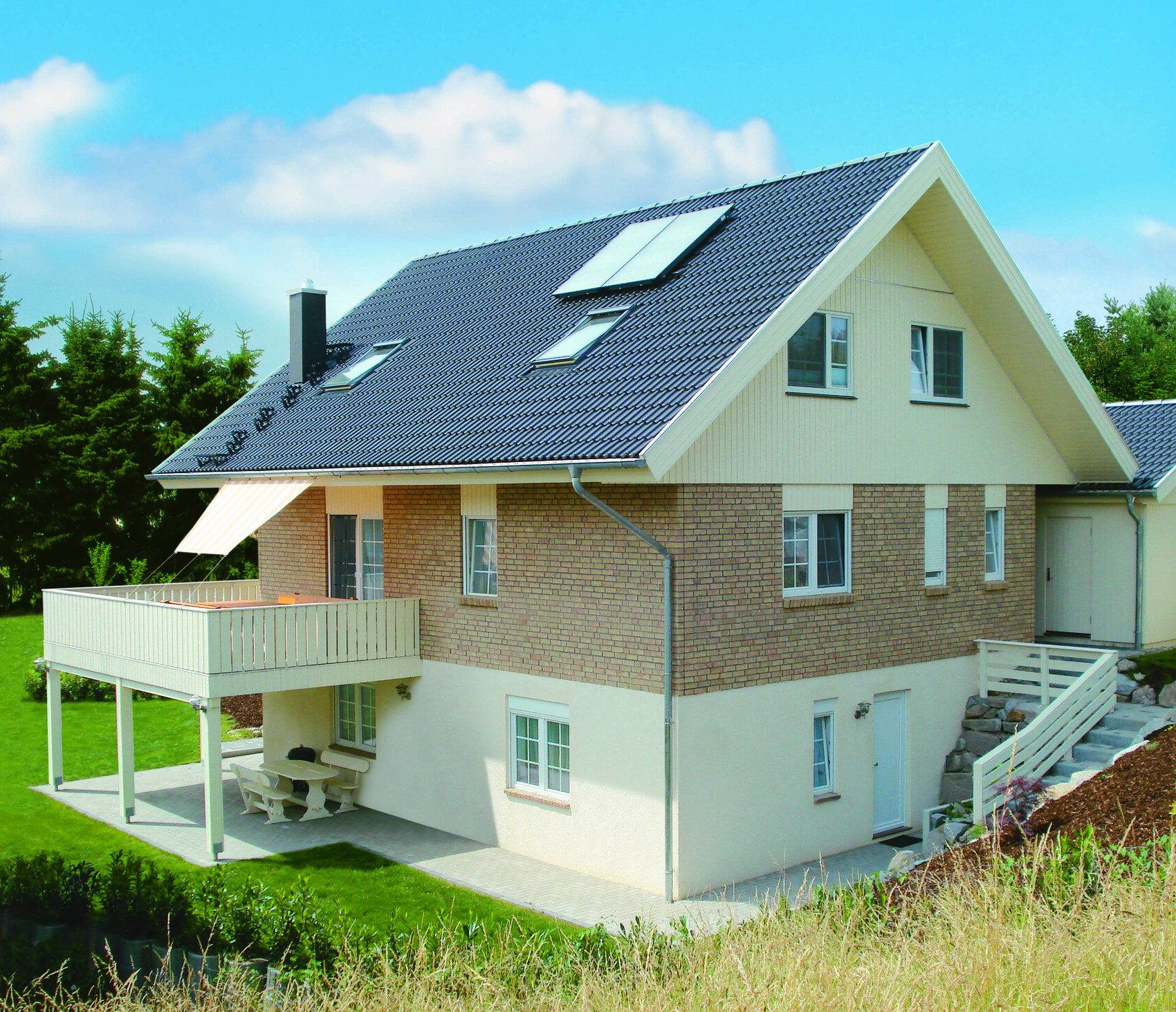

The commonly quoted benchmark prices, whether 1,200 EUR/sqm, 1,500 EUR/sqm, or 2,000 EUR/sqm, refer to the above-ground living area including the concrete slab. There are hardly any cases where a true basement apartment is built, meaning a clear ceiling height of 2.50 meters (8 ft 2 in) plus an additional approximately 20 cm (8 inches) floor construction, underfloor heating, proper windows like those on the ground and upper floors, ventilation, the same number of sockets as on one of the above-ground floors, and so on. Many build an insulated, possibly even heated basement, but without the ceiling height and appropriate windows, in my opinion, this is not a real basement apartment. That is why some say they have converted a few rooms into basement living areas. This usually happens when the basement floor is exposed on one side because the building is on a slope. Something like this would be a basement apartment, at least a few rooms on one side:
