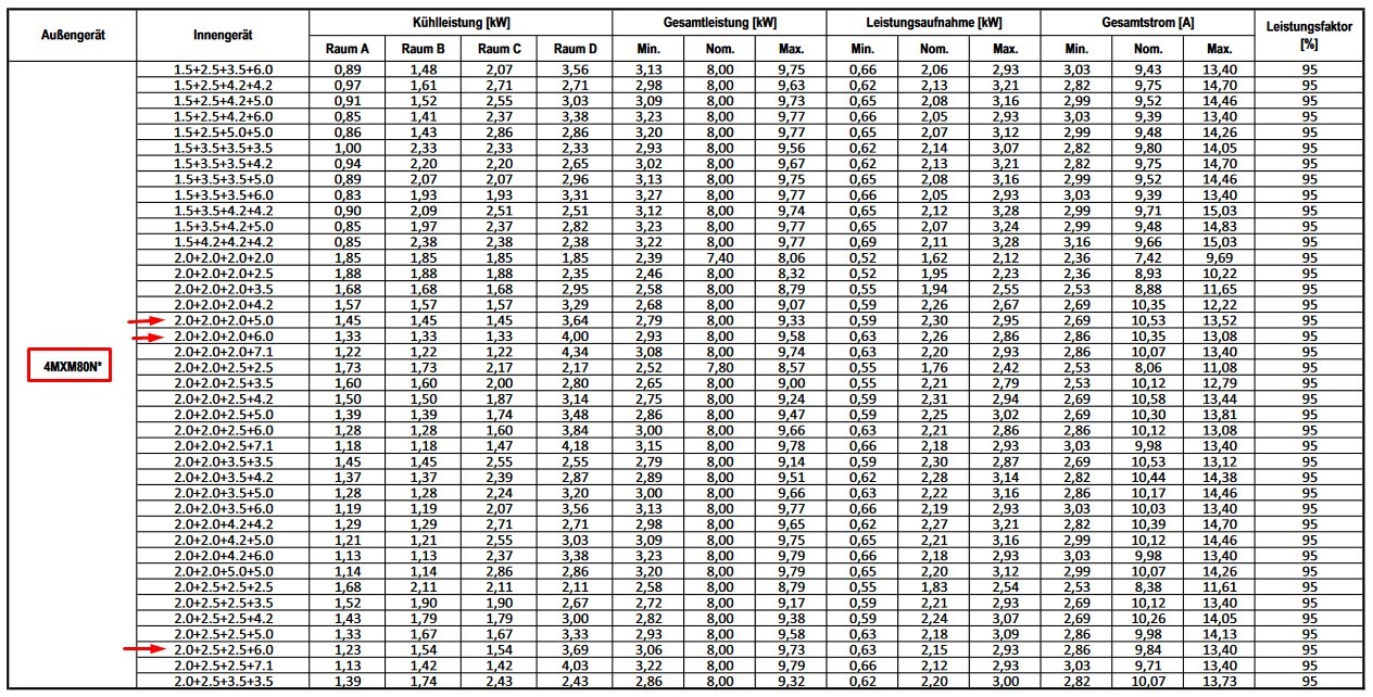

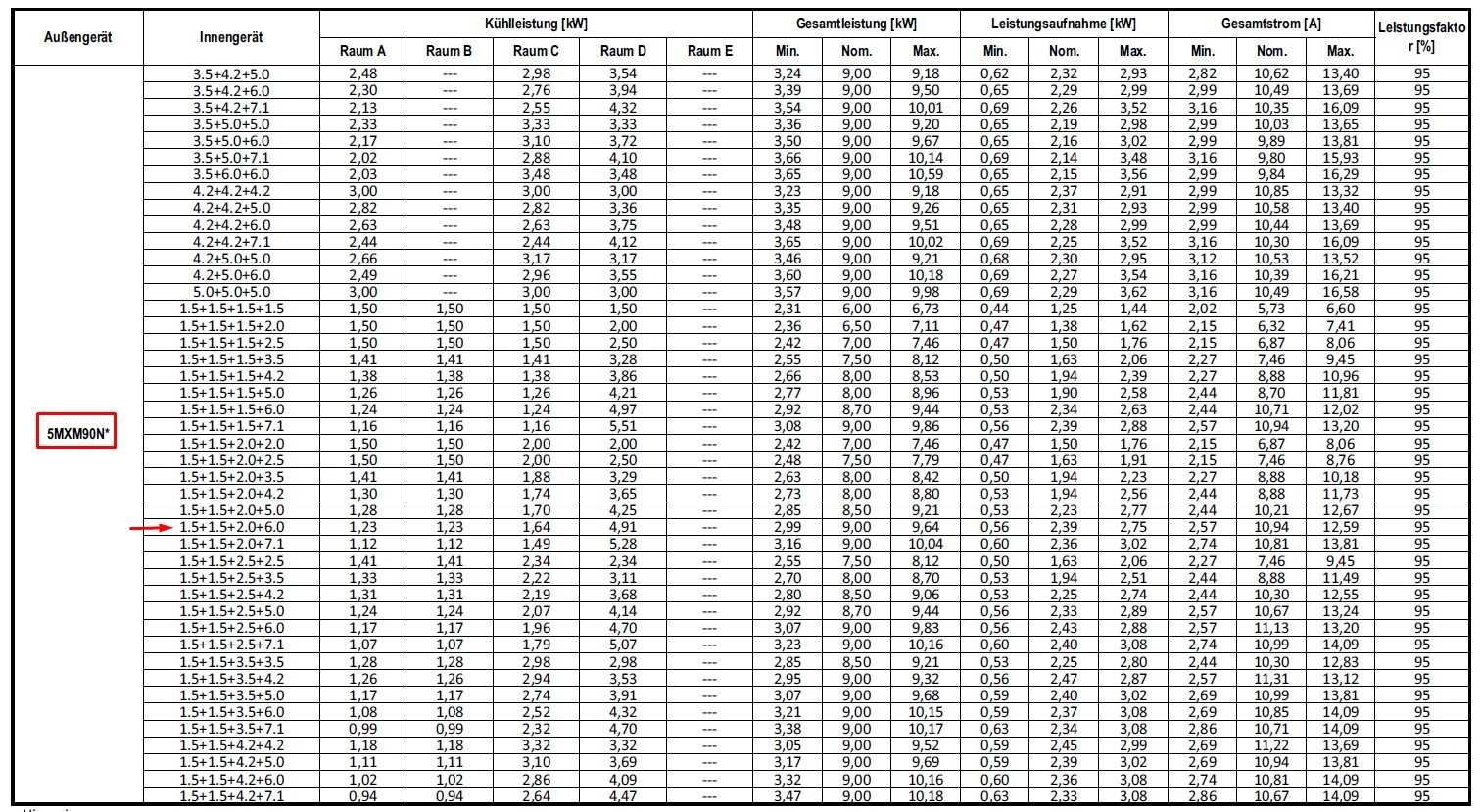

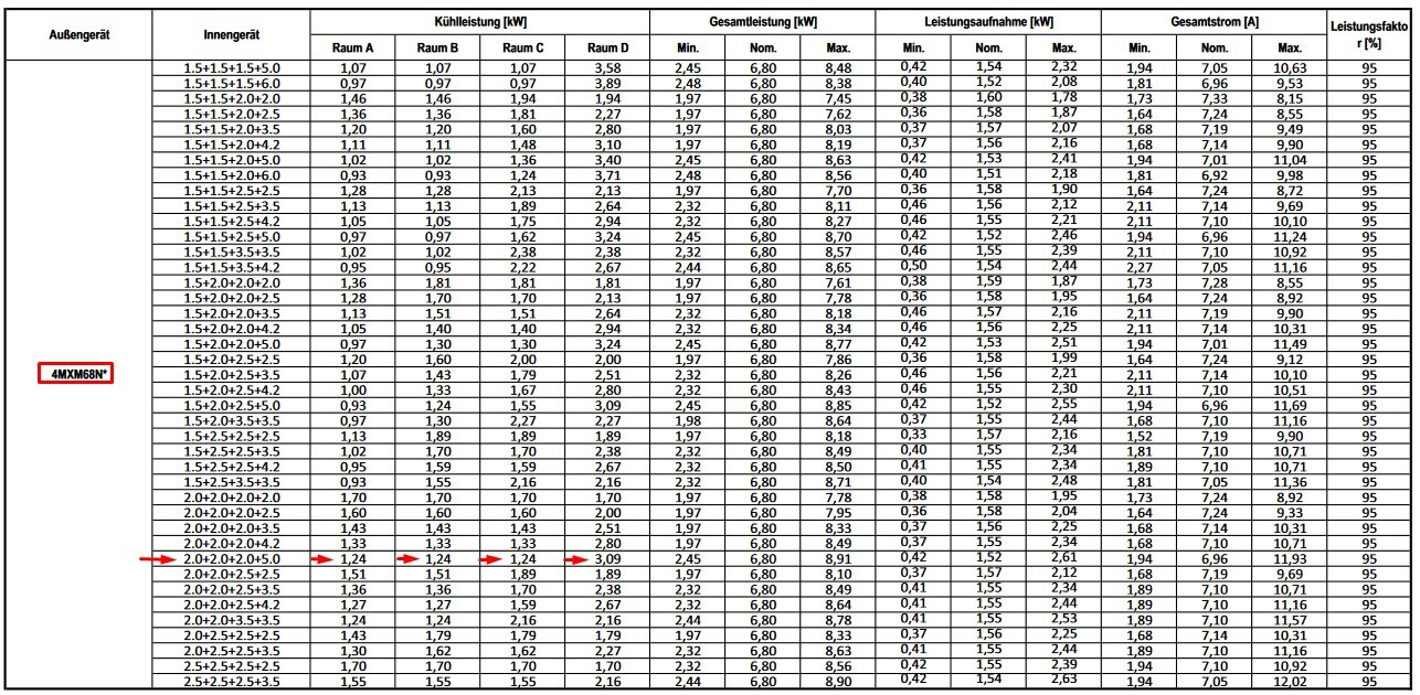

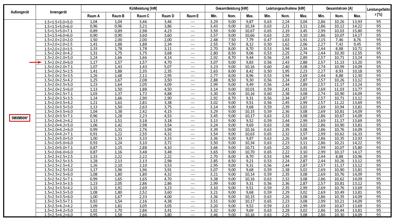

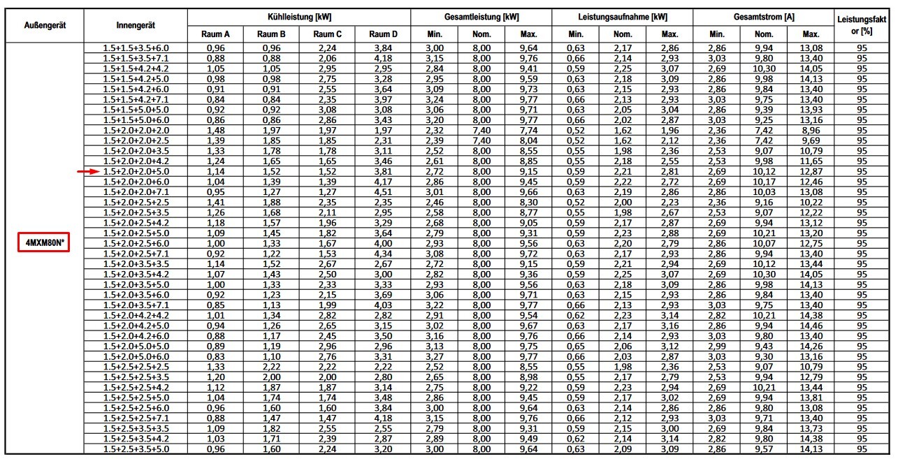

Then it needs a 4MXM80N model, as a 4MXM68N would not be sufficient. Even the 80N is already reaching its limits. For an area of 52m² (560 ft²), I would tend to choose the 6kW version instead. The tables show the net cooling capacity you can expect with different combinations (I just selected a few). If you want to maintain the 100W/m² (3.2 BTU/ft²) cooling capacity, you can see where this leads.
So the outdoor unit is the 4MXM80N, which I can tell from the specified weight. The outdoor unit is listed at 67 kg (148 lbs), whereas the 68N is only 63 kg (139 lbs) according to the technical data.
