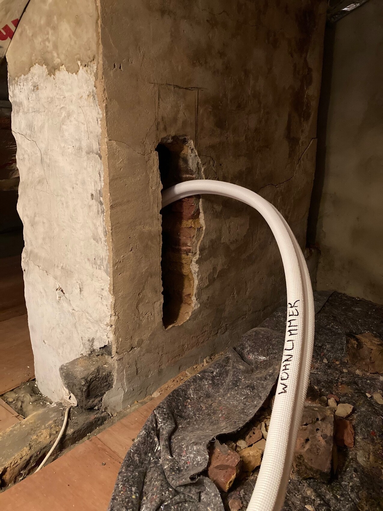

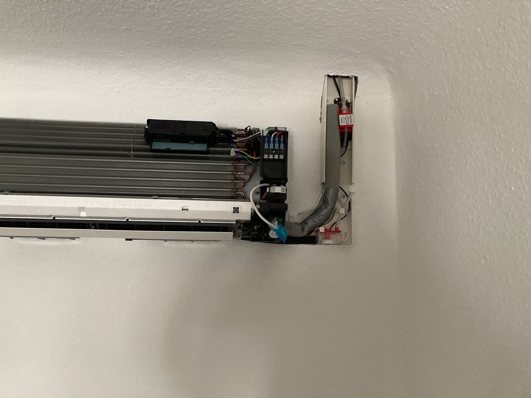

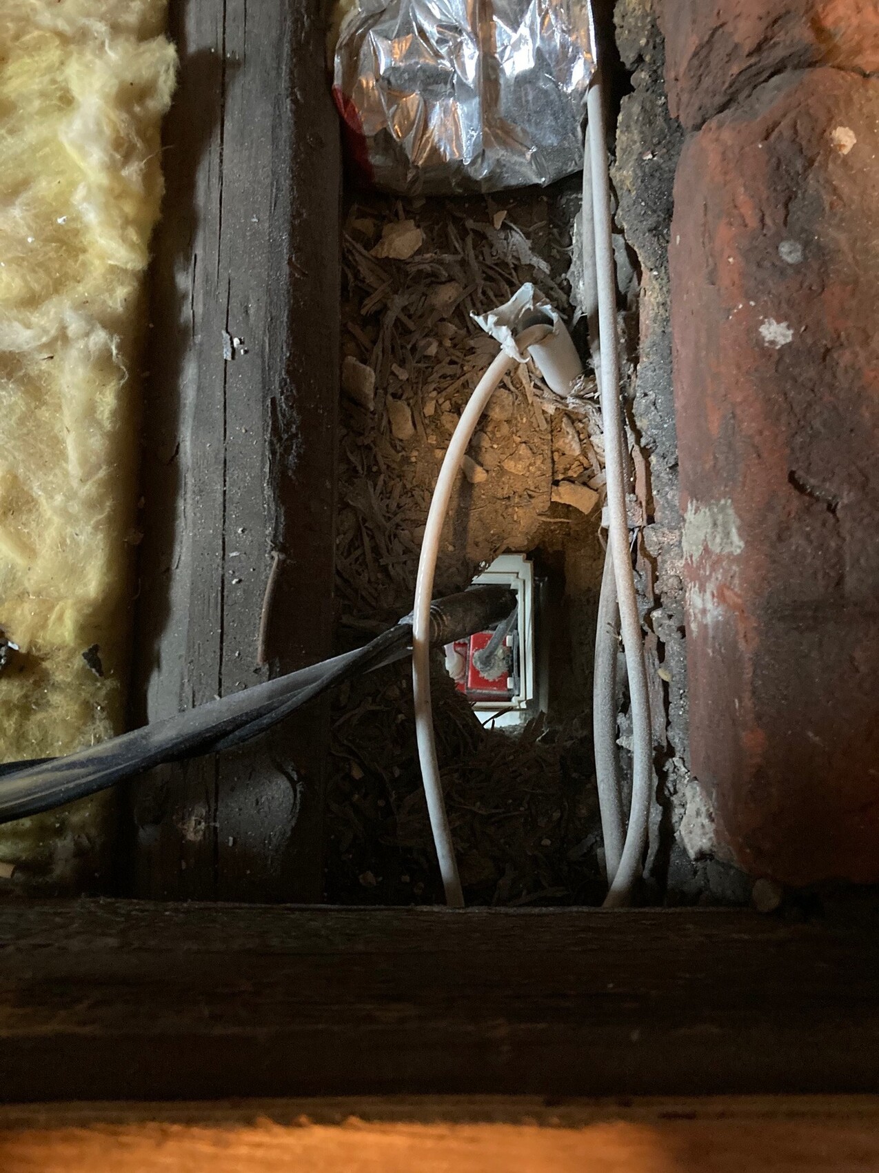

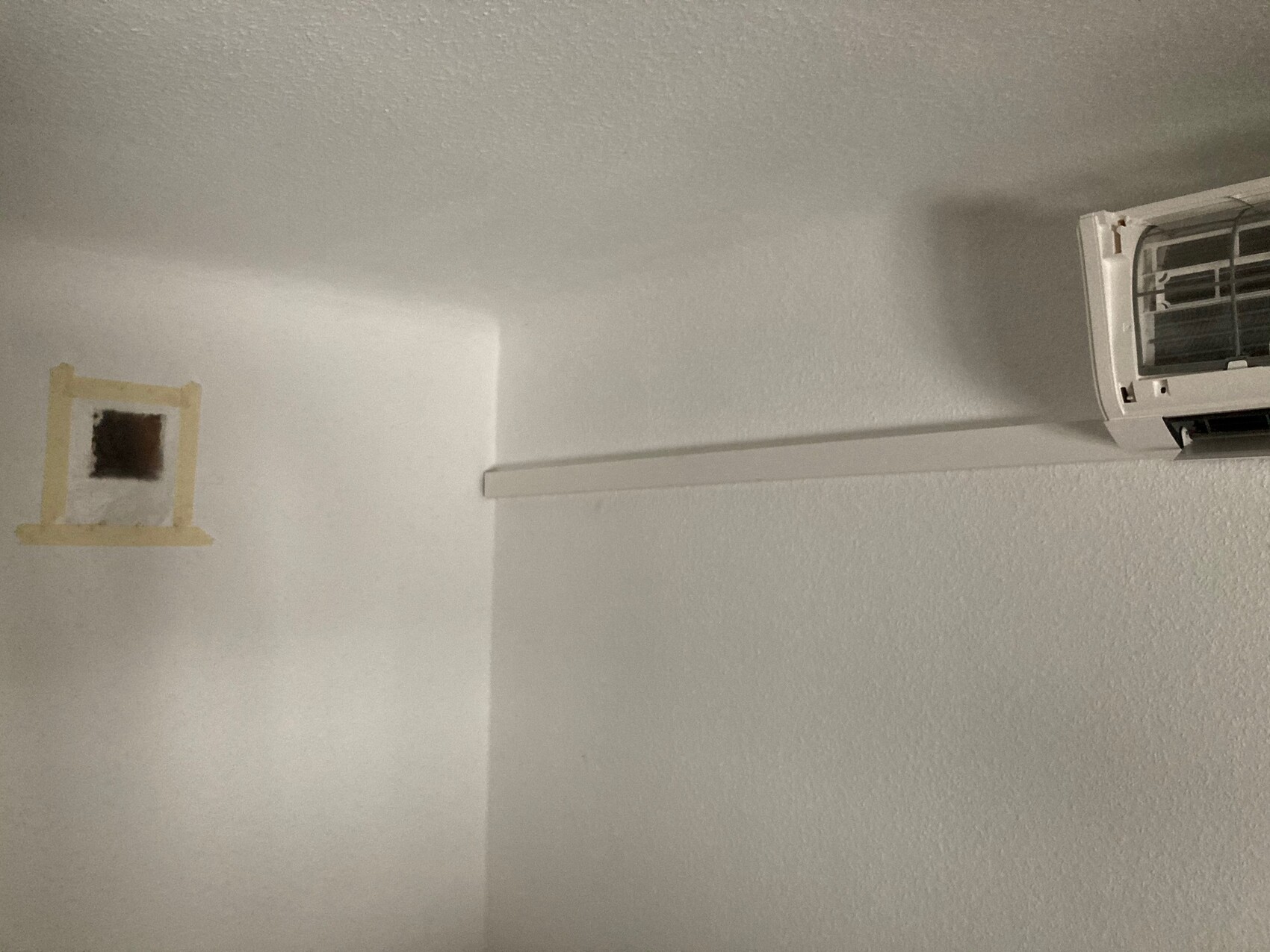

I will provide everything once it’s completed! Or at least a few initial pictures. One shows the access to the chimney flue used for distribution, then the bedroom with access from the attic (here a condensate pump was unavoidable), and the other picture shows the children’s room (95% of the cable duct is hidden behind the wardrobe):
Unfortunately, I can no longer make changes, but the work is really very neat and limits the “damage” or openings to a minimum. I’m really curious about the outdoor unit, which is supposed to go on the roof today. Through the skylight and then onto a bracket.
In the living room, it looks similar to the kids’ room, so we’ll have to come up with something to possibly “hide” the cable conduit there. We could have installed the indoor unit directly on the chimney flues there, but that would have meant worse air distribution, and for me, function simply takes priority. Still, you can get creative and maybe make it disappear with an eye-catching design; let’s see — for now, we’re still missing the right idea. It’s installed at about 2.50 m (8 feet 2 inches), so having a cabinet there is no longer an option.

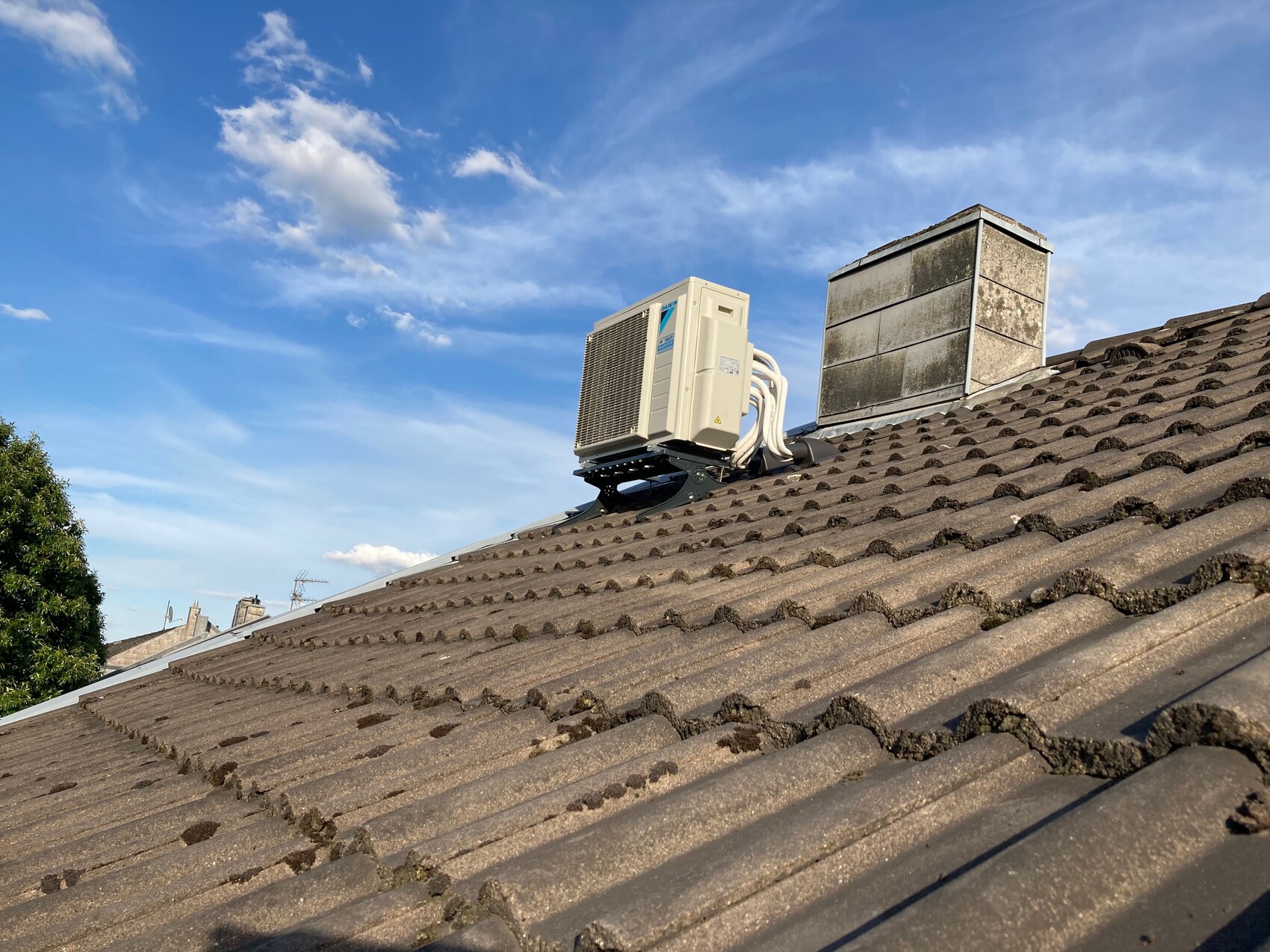

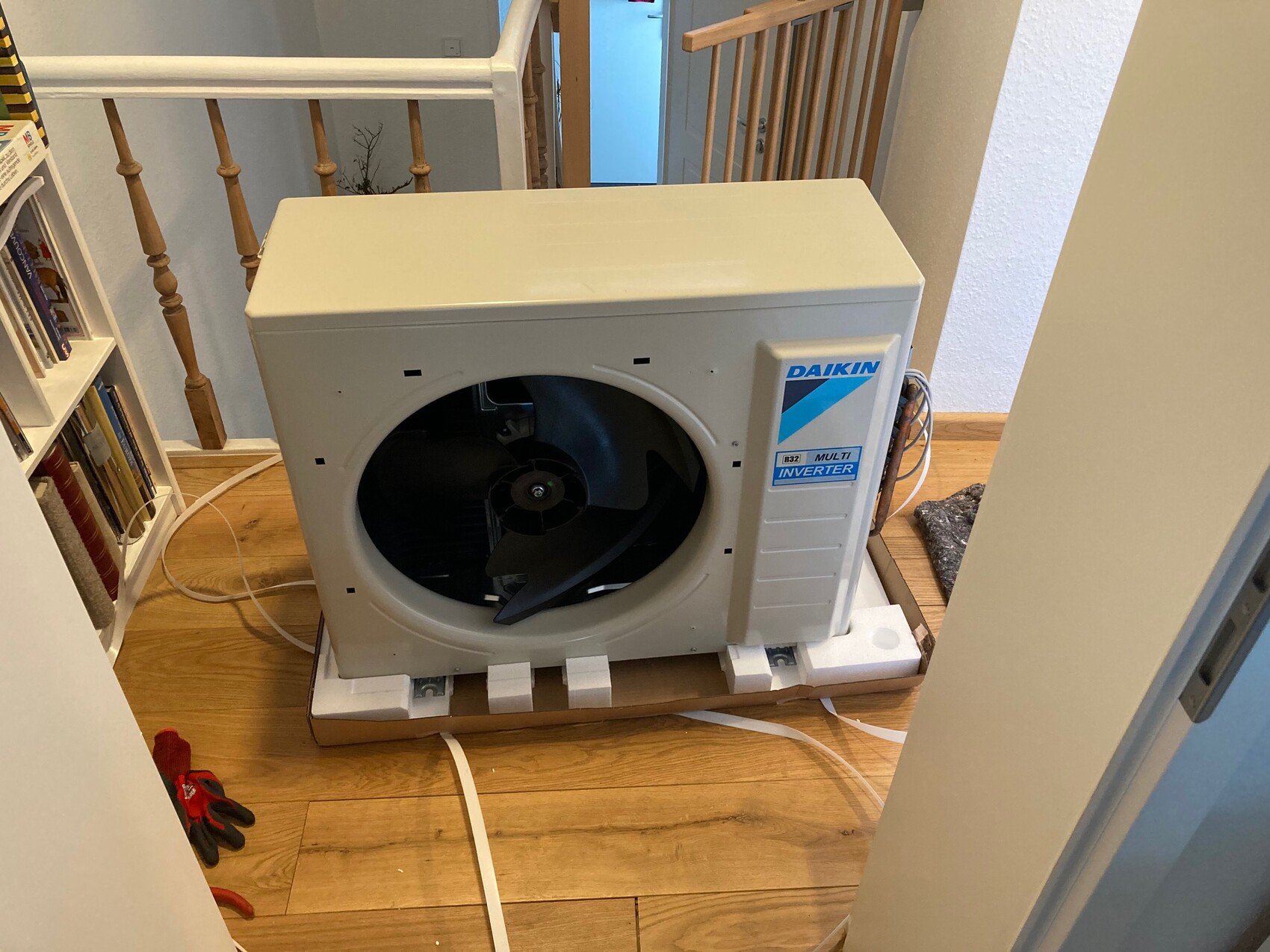

The outdoor unit is installed and the system is running; the only thing left to do is the condensate drain. There was a minor "issue" because a part was missing due to a misunderstanding. However, this will be addressed soon, and then the commissioning and briefing will take place. They had to carry everything up to the roof, but everything looks clean and tidy:
