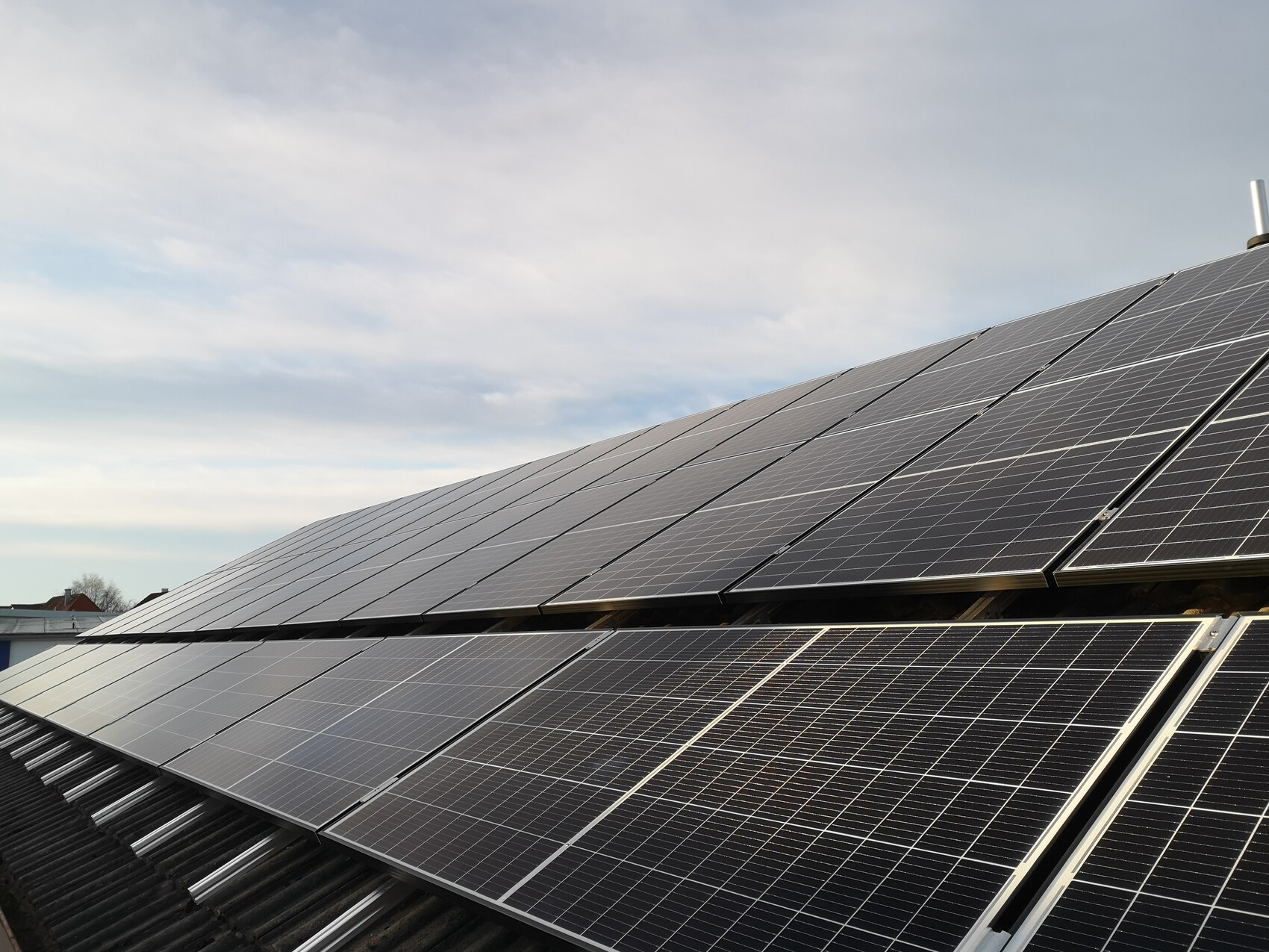

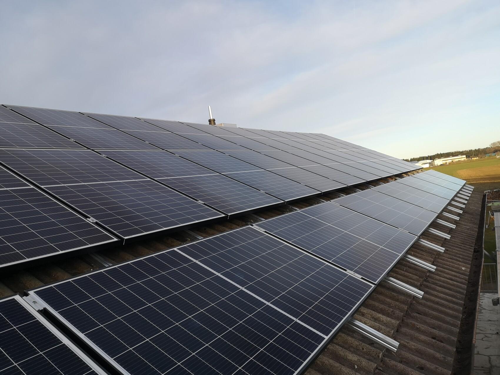

I only have west and east orientations.
I filled all available space as much as it made sense for me, considering shading from chimneys. In total, I ended up with 24.48 kWp.
Most people look at me strangely and are surprised because the system is so large. Usually, installations are only done up to a maximum of 10 kWp. But my system will generate about 18,000 (currency) over the next 20 years without investing an extra cent. (Completely calculated after taxes.) Everything is financed. And from the very first year, it has a positive cash flow. I just have to pay the value-added tax upfront for a short time until I get it refunded by the tax office.
So, it definitely makes sense!
And as soon as possible!
The feed-in tariff decreases every month. So go full throttle, don’t waste another day and therefore no money.
Sometimes it takes up to 4 months before they can install the system for you because they are fully booked. But in reality, the process only takes a few days.
I regret not having installed the photovoltaic system when I built the house 4 years ago. Then the profit would have been significantly higher.
I got 5 offers and finally chose the one who already installed the 5th system for my neighbor. So, a recommendation.
Oh, and talk your husband out of getting a battery storage. It’s not worthwhile financially or environmentally.
Regards
Specki
