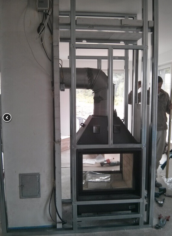

nordanney13 Sep 2021 20:17Something like this? A see-through fireplace? A few years ago, it cost us around €10,000 (+/-). But not from Hark (which is basically a DIY store for fireplaces). It was a Spartherm, installed by a professional fireplace builder.
If you want to build the fireplace yourself, you can pay just a fraction of that price. The fireplace insert alone should be around €1,500 to €2,000 if you don’t insist on a “brand.” The rest is drywall construction and connection materials.
We have the Neocube P20.
It features a fantastic panoramic glass panel (kit) with selectable colors. Heats very well. However, we have a chimney with double flow (separate fresh air intake and exhaust) – Schiedel Absolute. The price for the fireplace including installation and connection was under 6,000.
