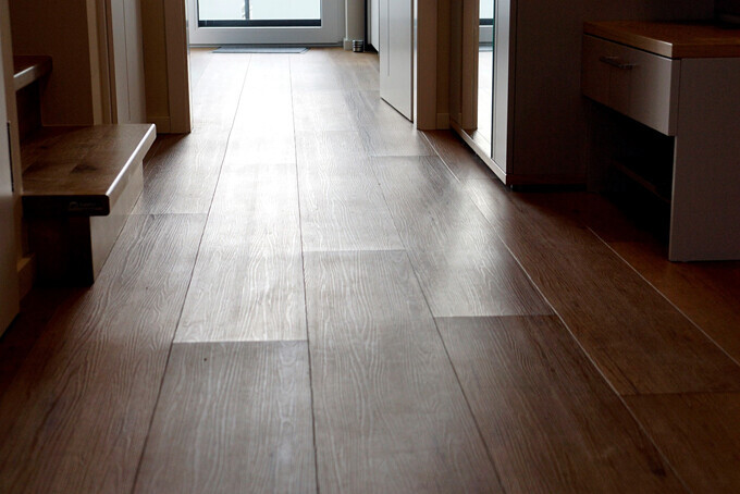

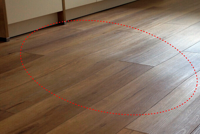

Thirdly, as already mentioned in one of the posts, PE film also acts as a slip layer. Floating floor coverings will always move, whether due to thermal expansion or moisture absorption from the air.
If you restrict the expansion behavior of the floor covering, the floor surface may soon look like in these two attached pictures.
Here, a floor covering with a cork backing was installed directly on the actually still unlevelled screed.
My advice regarding the necessary correction (removing the covering, installing a double layer of PE film, and reinstalling the covering) was ignored by the contractor. It will soon become apparent what will happen when the underfloor heating is in use. Although I already know...
Short answer to your question: Yes, install a single layer of PE film about 0.15mm thick!

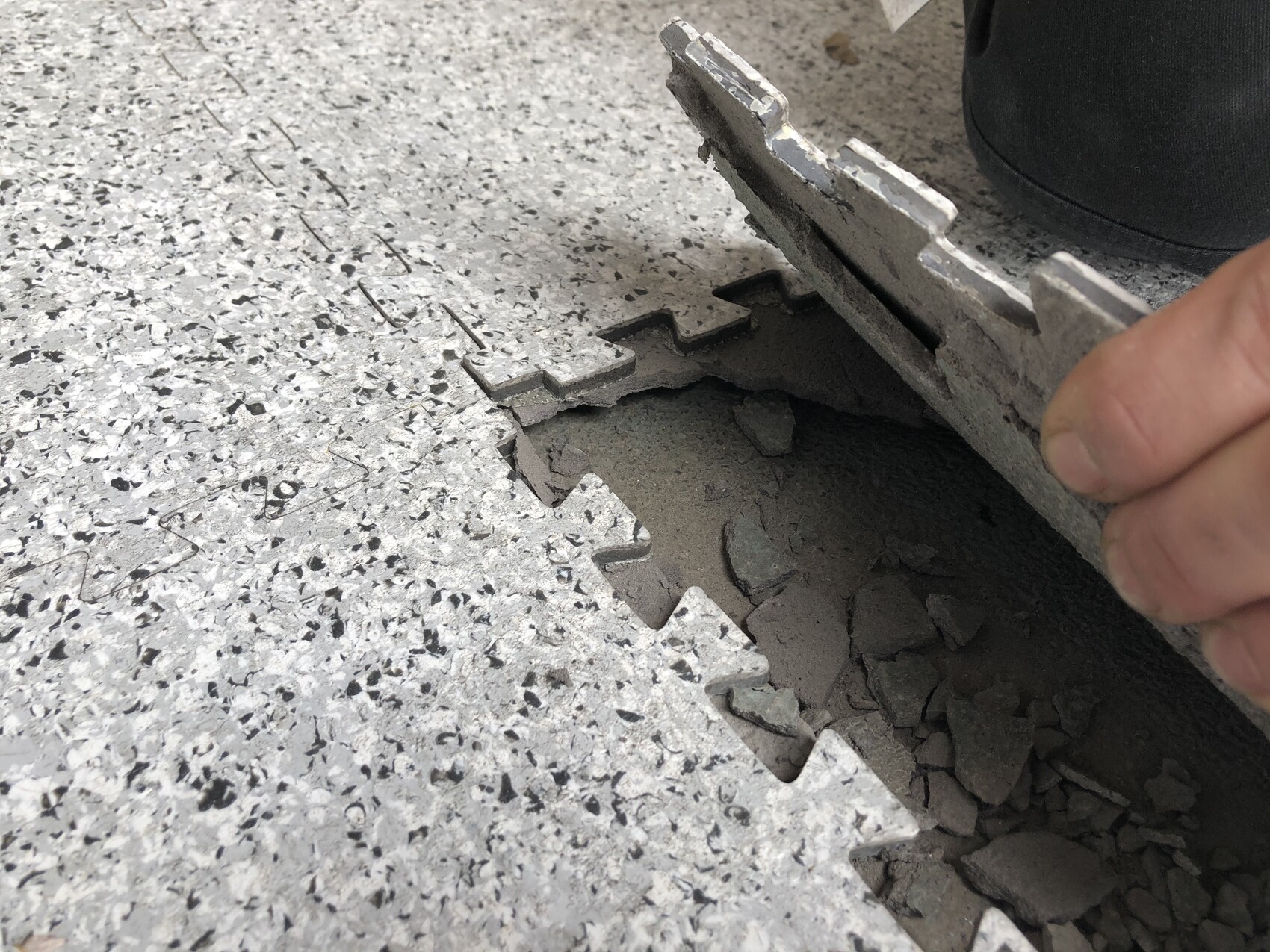

Think about what you are doing with the sheet. The moisture you are assuming will cause long-lasting mold growth under the sheet ;-) The floor installer applied a gypsum-based leveling compound. I am currently a little concerned that mold might develop under the sheet (which lies on top of the leveling compound), since gypsum is said to be very prone to mold.
Hausbaer schrieb:
... because gypsum is said to mold very quickly.However, that is a misconception; pure gypsum does not mold since it is purely mineral-based.@ Hausbaer: Those who emphasize the topic of "mold fungi" usually have no other "killer argument."
The fact is that polyethylene (PE) foil always belongs under any floating installation of wood/wood-based materials as well as cork flooring.
If a gypsum-based leveling compound was used here for surface leveling, then please consider the PE foil only as a slip layer for the future floor covering.
If the situation should arise later that, for whatever reason, moisture rises from the back and the screed releases its excess residual moisture "upwards" (toward the center of the room), you will undoubtedly notice this from other signs even before any mold spores can settle: there will be creaking with every step you take.
It creaks because the gypsum-containing leveling compound has detached from the screed surface and crumbled.
No, this is not a joke or an unfounded claim; it corresponds to my practical experience. It looks exactly like in the attached photo.
So don’t be misled by comments that miss the point.
You asked here in this forum, you received at least one useful answer, and now you must decide on your own which path to take with full responsibility.
