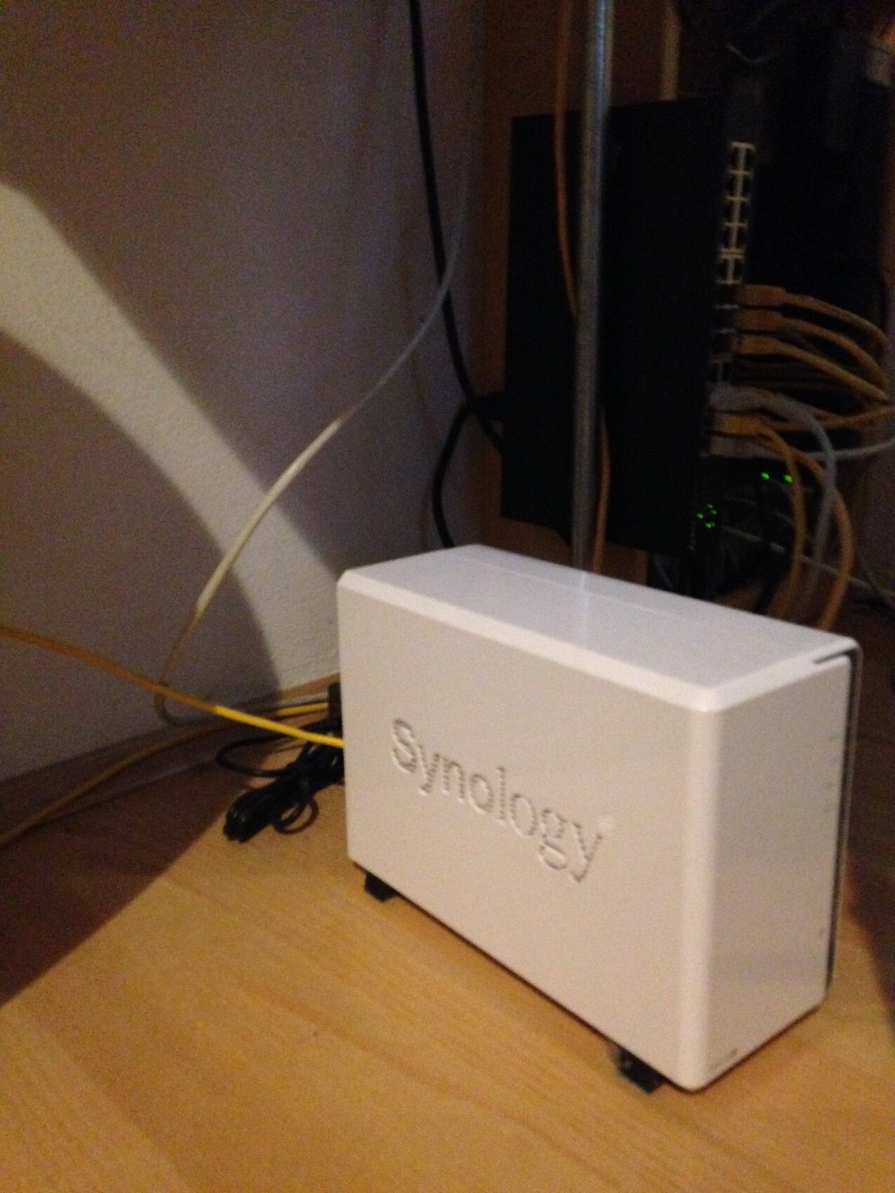

For my part, I have an 8-user system with 4 satellites and a medium-sized NAS for content that I want to watch non-linearly throughout the house.
And the total cost didn’t exceed 1,000 euros. What else is there to think about???

My setup cost 1000€ (A large part of that was for the NAS).
