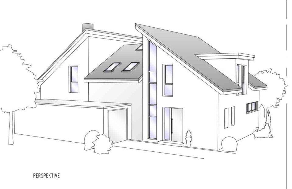

Attached you will find a planned house (I’m not allowed to show the built original; this is a client requirement) as a detached single-family home measuring 5.50 m x 16.50 m (18 ft 1 in x 54 ft 1 in) and a semi-detached house with similar exterior dimensions (making full use of all “exceptions” allowed by the building permit/planning permission).
Everything is possible; I’m sure Hanse Haus also has excellent architects.
Best regards, Bauexperte
