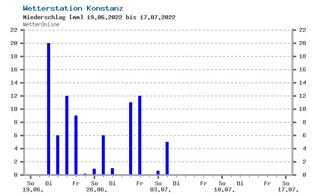

rick2018 schrieb:I don’t know how it is in the Black Forest region, but in Upper Swabia, several districts have already prohibited watering from rivers and lakes. And even though the rain in June looks much better than in Haydee’s case (see screenshot, although there were also some heavy thunderstorms), there are already some brown spots appearing on non-irrigated areas here. And practically no rain is forecast for the next two weeks.
