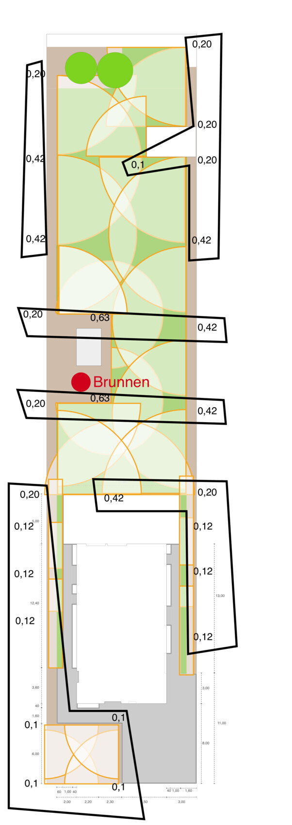

Once these basic questions are clarified, I would like to focus on detailed planning. I have already attached a first version. Our plot is relatively narrow and long—about 15 by 75 meters (50 by 246 feet)—but so far it does not seem to pose a major problem.

Now, a few detailed questions about the planning.
  • Attached are the planned zones. Most of the sprinklers are lined up in series, also due to the shape of the lot. How problematic is this? Usually, it’s recommended to branch the zone instead.
  • How do you handle unplanned areas? The rectangle at the top edge of the lot is a garden shed that’s only tentatively planned so far. Should we roughly fix its size and position and plan the sprinklers accordingly around it?
  • I want to distribute about 3 Gardena-style water outlets around the property. I’ll branch off their common main line (3/4") before the valve box with a T-joint and keep them constantly pressurized. Does that make sense?
  • For the area around the well (greenhouse) and also along the property edges (hedges), I want to at least prepare piping now, so I can install drip irrigation later if needed. For now, these lines will be capped. (The plan is for an 8-zone valve box and a 12mm (1/2 inch) Hydrawise controller.)
  • Are there significant differences in the fittings? There’s about a threefold price difference. Is a Unidelta T-joint 32 x 32 x 32 really worth €8.10 when you can get the same from HTC for €2.45?

rick201823 Apr 2020 22:15
1. Pressure-regulating housings mean there is no problem if the sprinklers are installed in series, as long as at least 2.8 bar (40.6 psi) reaches the last one.
2. Yes, plan the "outer loop" from the start. If it will only be installed in a few years, use normal irrigation for now and relocate the sprinklers during construction.
3. Branch the water outlets before the valve box. There are few cases where a valve is necessary or useful. As long as the pump is powered, the outlets can be used.
4. Place the reserve lines for, for example, drip irrigation at the intended spots right away. Leave them sticking out of the ground a bit and cap them with an end plug.
5. I have had several cheap fittings break (some already during tightening) or later leak. Most connections hold without problems. I now only use Unidelta fittings, which I have yet to experience any failures with. Of course, the additional cost adds up significantly, but I don’t have to dig up the garden again. It’s a risk assessment. If you document the location of your pipes and connections well, you can also use the cheaper fittings.

opalau23 Apr 2020 22:51
@rick2018
1. You mean the PRS40, right? Now I understand their advantage. I had only planned with pressure-regulating valves inside the valve box and thought that would allow me to skip using them in the sprinklers. Do I understand correctly that with the PRS40, I prevent a sprinkler at the beginning of the line from using too much water or causing a drop in pressure? Do I even need the pressure-regulating valves then?
Thanks for all the feedback. It’s really helpful to read that I wasn’t completely on the wrong track.
