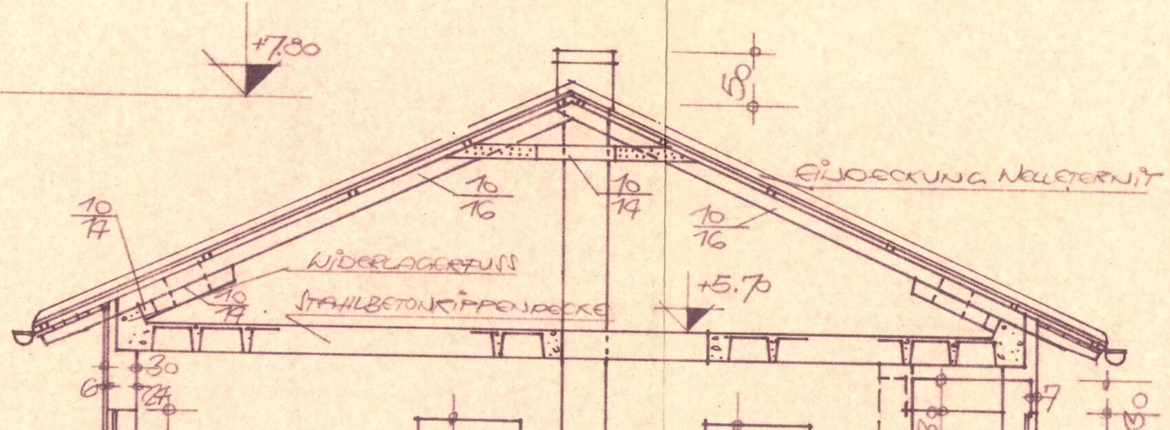

LostWolfWe are planning a major renovation of a single-family house built in 1961.
The ceilings on the ground floor and the upper floor are constructed as reinforced concrete ribbed slabs.
(Ground floor: Rib direction E <-> W; Upper floor: Rib direction N <-> S)
I would like to create an opening in the bedroom ceiling to have a view of the sky/stars.
Before I approach a structural engineer with this request, I wanted to ask if there are people here with experience in reinforced concrete ribbed slabs who could roughly tell me if such an opening is even possible and affordable.

Since your roof structure lacks the intermediate purlins, I consider the ceiling to essentially act as the bottom chord of a two-part truss system. This makes the request at least ambitious. If you are using corrugated fiber cement roofing sheets, you might also face more urgent issues.
