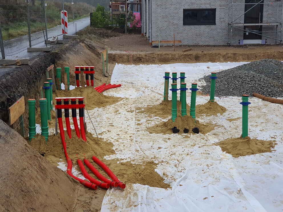

i_b_n_a_n9 Jul 2021 12:50
Maybe a picture of our multi-utility entry point (the red device) for reference (I didn’t know what one of these looked like before either 😎 )
Excavation pit with green and red PVC pipes, layers of sand, and earthworks, building in the background.

The multi-utility service entry is only 3 meters long for you as well, but was probably connected right at the street?
I'm not sure if it's 3 or 6 meters.
