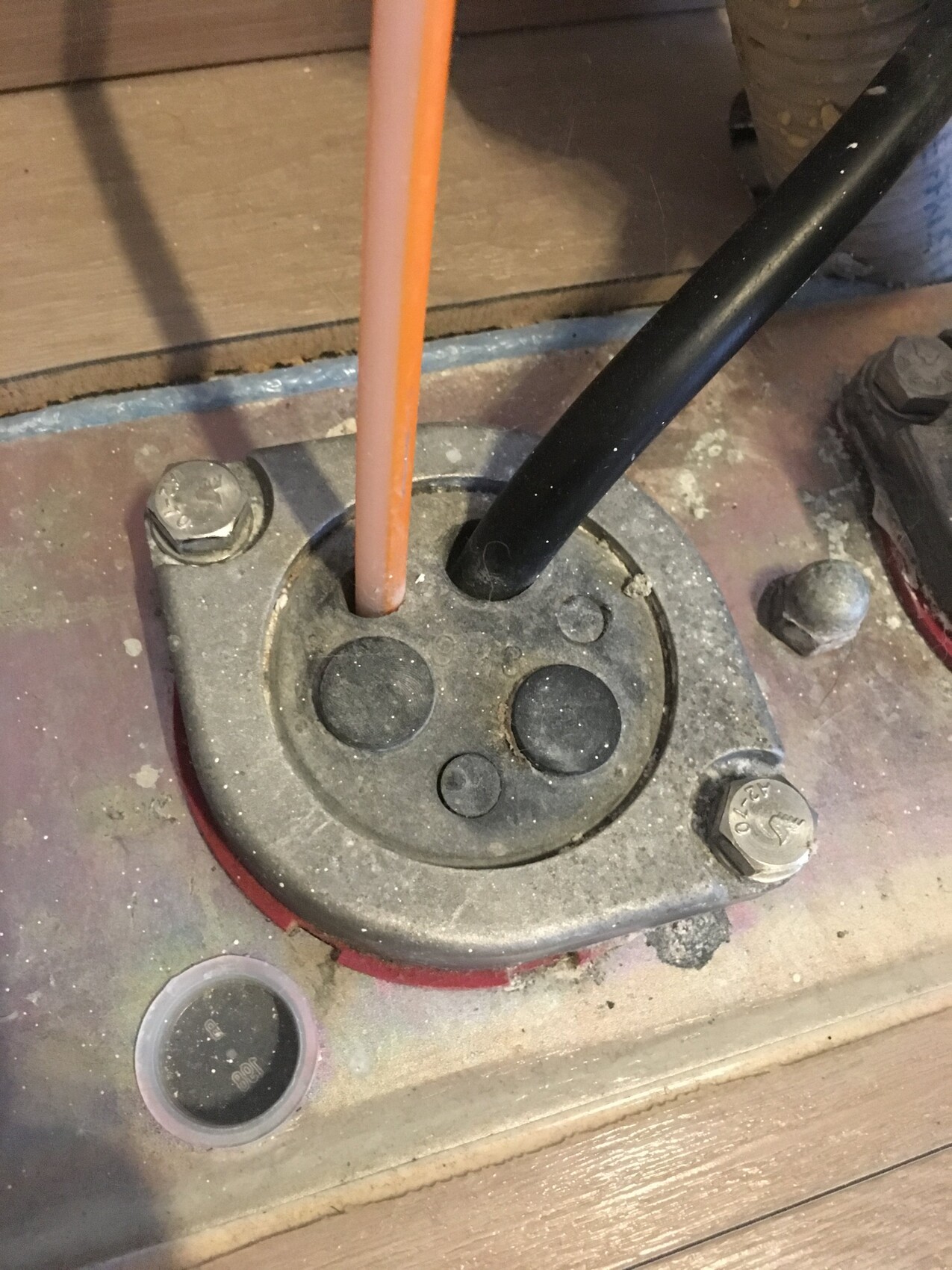

The systems I know have a stopper in the telecommunications section with several openings for different common cable thicknesses for telecommunications. Another cable should be able to pass through it as well. But since you still have a section in reserve, all options are open to you anyway.
