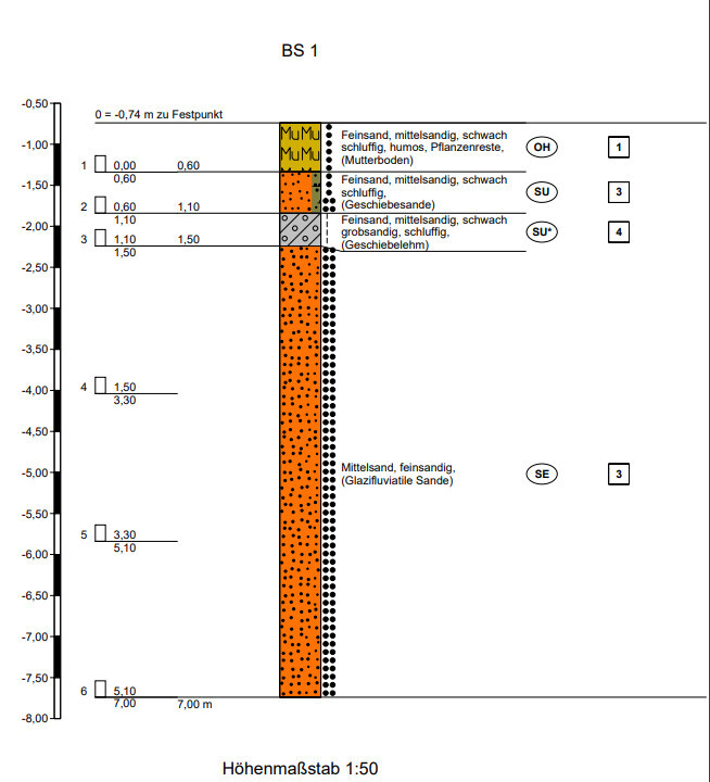

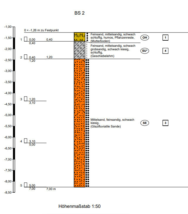

We have conducted a soil survey and are currently requesting quotes for the upcoming earthworks.

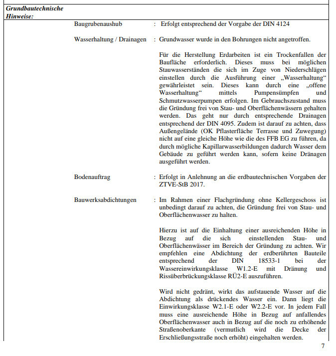

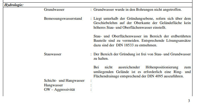

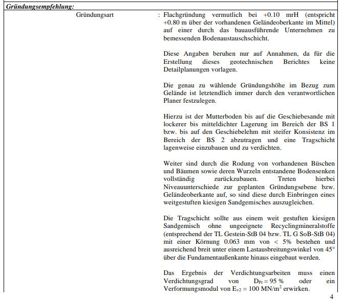

I am quite uncertain about the required removal of topsoil and the possible need for drainage work. I would be very grateful for your interpretation or explanation. I am posting the relevant excerpts from the soil report here.

You have the expert report and have discussed it here. From that, a specialized planner should be able to clearly determine which measures are appropriate or required. If both offers were equivalent (in which case the planner should have tendered both variants, not the bidder submitted two answers to one question), then it must be the case that the reason for the drainage is also buried in the depth layer “60 to 150 cm (24 to 59 inches) below the finished ground level.” Is that the case (yes or no; I wouldn’t want to build based on “maybe” in the literal sense)?
