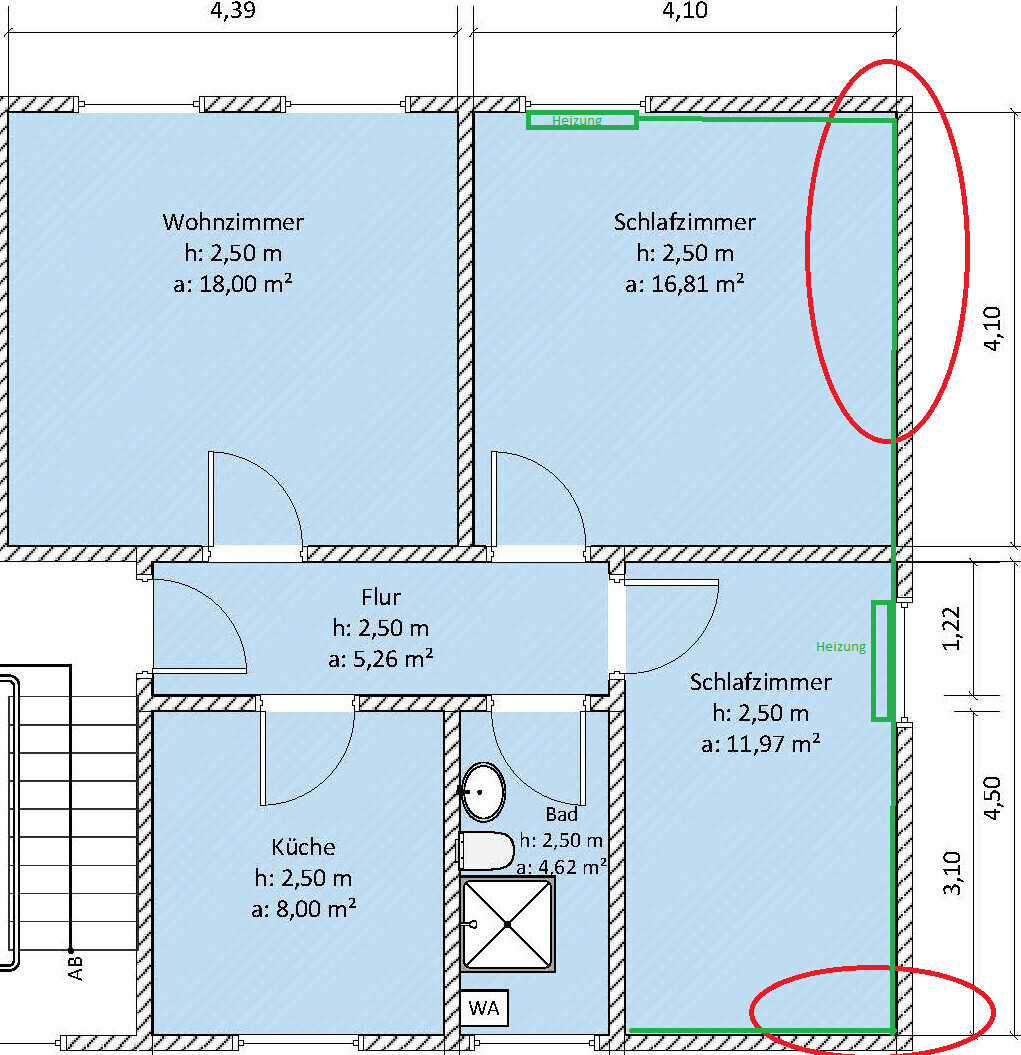

I have a question regarding my rental apartments.
In the rental units, I occasionally find mold spots at the locations circled in red in the picture for some tenants. Several apartments across multiple buildings face this issue, with about 4 out of 12 currently affected.
The exterior wall is a 30cm (12 inches) clay wall, plastered on the outside and painted 5 years ago. There is no additional insulation.
As shown in the picture, the construction promotes mold growth because the windows and doors face each other, and there is no air circulation in the rear corners.
From what I have read, the high indoor humidity caused by activities like sleeping, combined with warm air from heating and the cold exterior walls, causes condensation, leading to mold formation.
Regarding my idea:
Would it be beneficial to install an interior stud wall with insulation, a vapor barrier, and plasterboard on the exterior walls?
My hope is that the heating pipes running between the exterior wall and the new stud wall (shown in green in the picture) would create a warm insulating layer.
This could reduce mold growth and slightly lower heating costs. Given the room layout, I probably won’t be able to completely eliminate the problem if tenants ventilate or heat incorrectly. However, I want to at least ensure that normal ventilation and heating are sufficient.
A full exterior wall insulation is currently not possible for economic reasons.

nordanney6 May 2020 13:00I am familiar with this topic from my own rental experience. We insulated from the inside using calcium silicate boards (professional company). With drywall, you really lose a lot of space for the tenants—and whether it even works properly (dew point shift) is another question. The results so far have been so-so, but definitely a noticeable improvement.
kasimir_826 May 2020 14:24What did you do to the panels? According to the panel specifications, textured wallpaper is not suitable. Only fiberglass wallpaper or breathable coatings are allowed. Does that mean I would also need to repaint or cover the interior walls?
