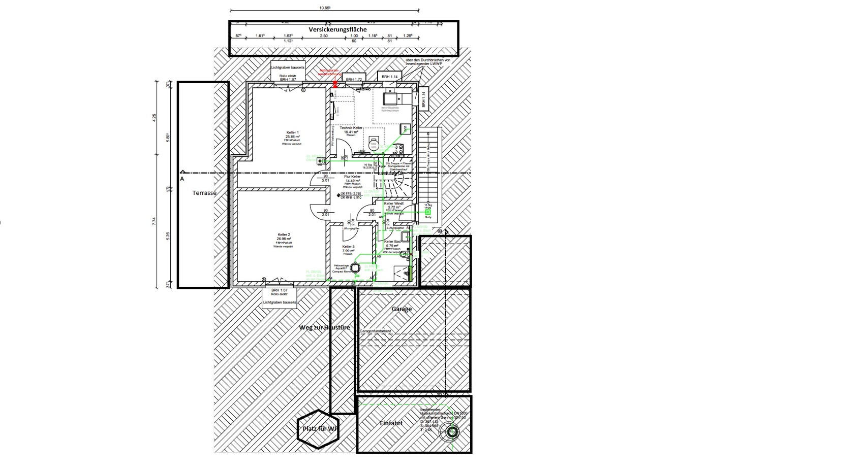

Let us know if there are any new developments! Maybe you’ll get helpful advice if you share a bird’s eye view of your basement floor plan and the plot? We got some great tips that we hadn’t thought of ourselves. I haven’t had a new appointment with the GC since then. In the last discussions, the indoor heat pump was clearly rejected if I insisted on it, without any guarantees. However, a friend who is an architect sees no problem with an indoor installation, as long as it is done “properly,” but the GC does not want to hear that.
This is the situation. For me, the only reasonable place for the outdoor heat pump is next to the garage driveway, although that is also quite far away.
I am now arranging an expert for construction supervision to see what they have to say about the topic...
Allthewayup14 Jan 2023 13:01I have taken a look at the floor plan. @OWLer is absolutely right about the stairs leading to the basement. You can also find discussions online about how vulnerable basement stairs are when it comes to waterproofing.
Next are the two light wells with a parapet height of 1.02 m (3 ft 4 in) – I am also very critical of this. Among other things, waterproof windows (resistant to groundwater pressure) would need to be installed here (if such windows even exist or are permitted in this size). By now, I don’t understand your general contractor either, when he says he doesn’t guarantee the air vents but has no problems with the basement stairs and the light wells.
We also have a light well, and precisely because of the risk of groundwater, we set the parapet height to 1.45 m (4 ft 9 in) or even higher – especially since there were no approved waterproof windows in the required size.

After seeing your floor plan, the air vent is your smallest problem here, and I speak from my own very recent and painful experience.

Could you explain exactly how the basement will be constructed? Formwork or precast panels? Thickness? What kind of concrete is planned? How will the joint between the base slab and the wall be waterproofed? Pentaflex membranes or injection hoses?
Do you possibly have an excerpt from your building description? I’m repeating myself when I say that many other issues need to be clarified rather than blindly trusting the general contractor – really, believe me...

Baskervile14 Jan 2023 14:12Don’t worry, the general contractor had plenty of concerns about the windows and the staircase as well. However, all of these issues were resolved. The windows will be installed as waterproof basement windows, though not in the size shown on the original plan (I don’t have the revised plan yet). There will also be a waterproof roof over the basement stairs.
I don’t have the construction description on hand at the moment. I only know that formwork will be used. Details about the type of concrete, etc., have not been provided to me. However, I assume everything will be appropriate. In this region, all basements must be waterproof against ground water pressure, and the contractor is a local supplier. From previous projects, I am not aware of any problems related to this.
