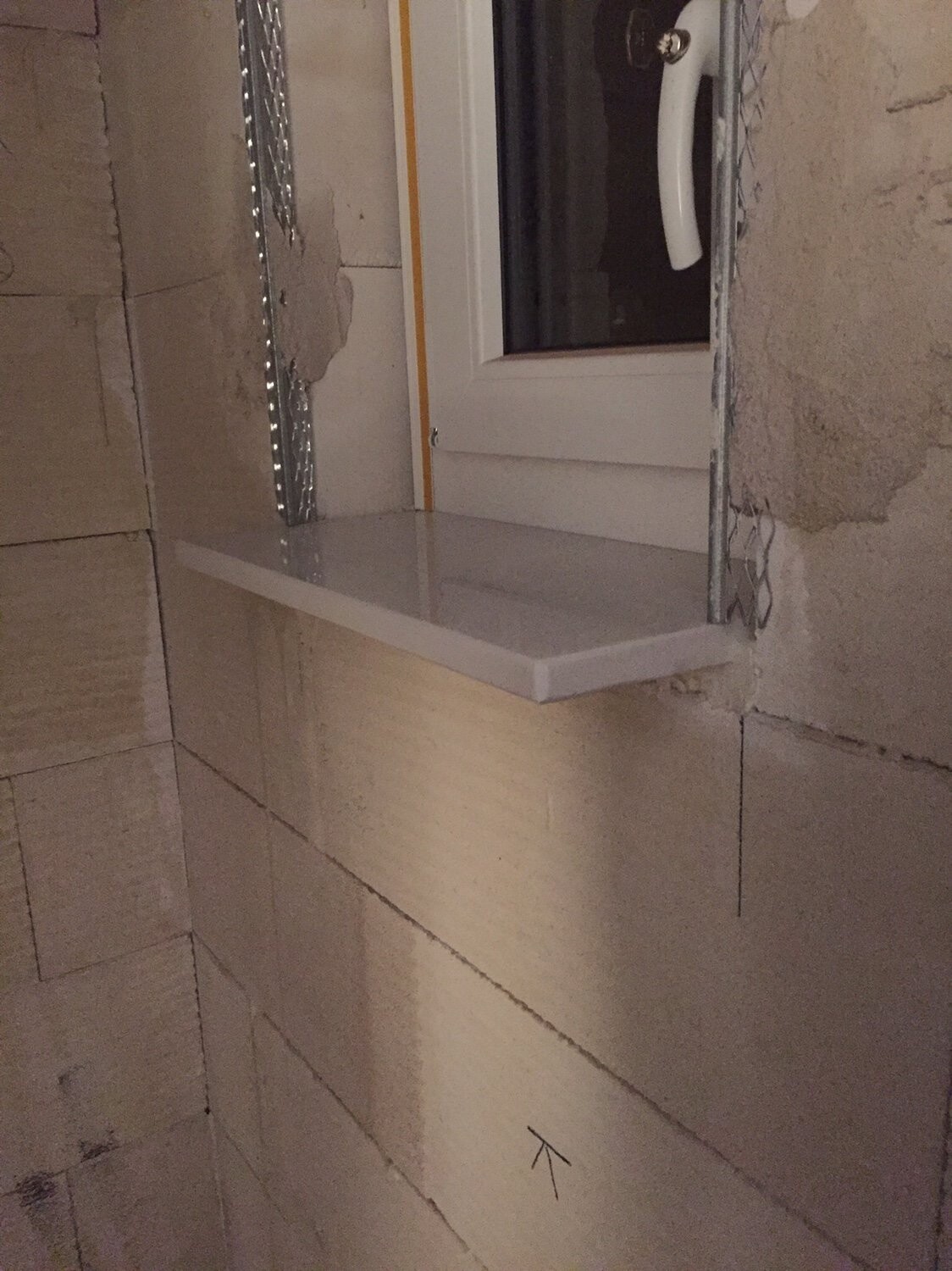

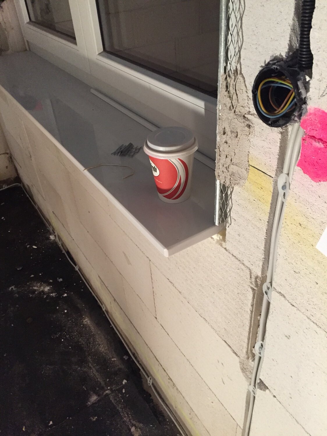

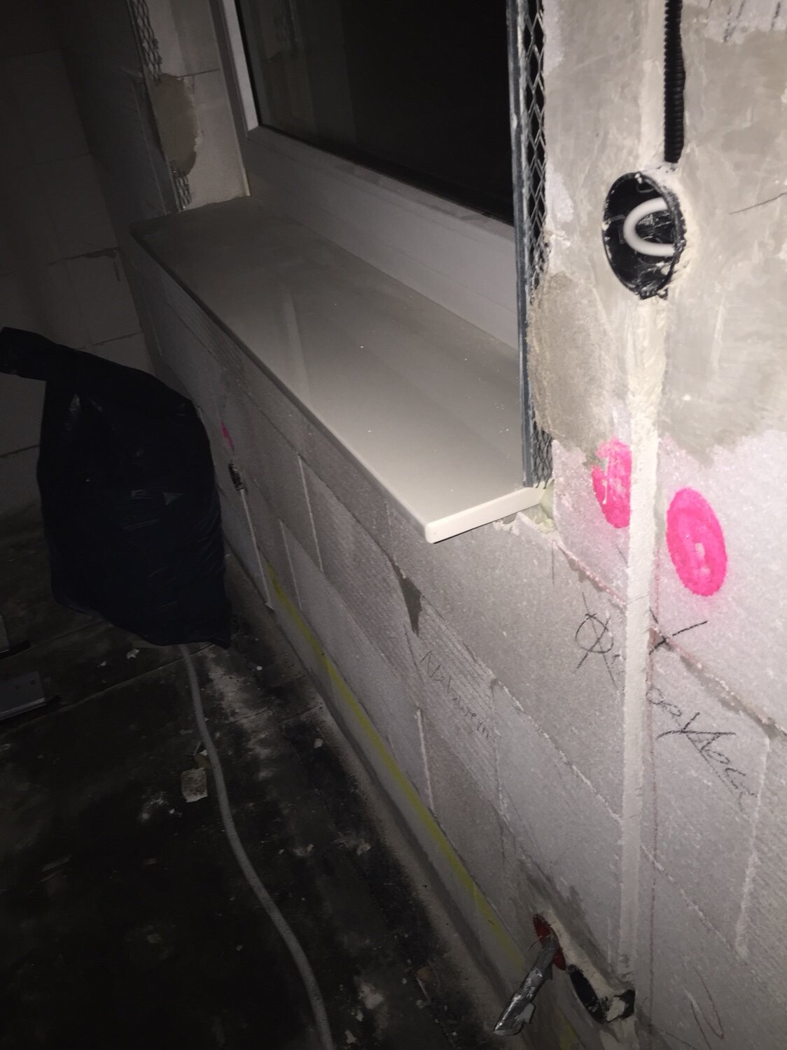

I was working away from home this week and stopped by the construction site briefly this evening.
I couldn’t believe my eyes.
The main contractor installed the interior window sills, but they protrude by at least 10 cm (4 inches), and probably around 8.5 cm (3.3 inches) after plastering.
Isn’t that unusual nowadays?
That was common practice in the past when you needed to hide radiators underneath.
Now all the issues begin, but surely it can’t stay like this, right?

This is secured with expanding foam; it will come off eventually. The question is who will pay for it.

No, that is not visible there. But based on common sense, if it is not explicitly mentioned, one would expect normal overhangs of 2–4 cm (1–1.5 inches), and not built-in serving trays.

I quickly looked into this online. It’s generally recommended to have an overhang of 2-5cm (1-2 inches), so your 8-10cm (3-4 inches) is definitely not typical. I would definitely insist that they remove it! Also, you can’t use the space behind it properly—for example, we have a printer placed directly behind our windowsill, and when walking by, you have to make a detour around the window. You can’t just make an arbitrary overhang and then expect the customer to be satisfied with it. In our case, there was a slight color difference on one windowsill, and the site manager had it replaced immediately, even though the interior plaster was already finished. It was done quickly without damaging the plaster, so it’s not a big deal.
