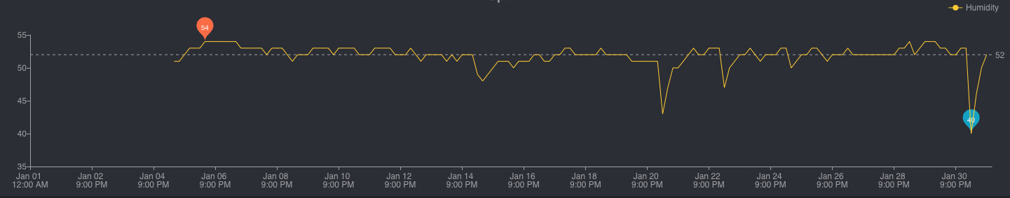

hampshire
26 Nov 2021 14:49
Mycraft schrieb:
Yes, that’s quite far-fetched. The air humidity drops to 30-40% in no time during winter if you don’t plan for an enthalpy exchanger. It doesn’t matter what kind of walls you have. Unless you spray them daily with a garden hose.
It’s not that simple. Here is our record from January 2021 – without an enthalpy exchanger:
Time series of humidity levels in January; yellow line; about 54% (Jan 4) and 40% (Jan 30).
Tiled stove, large room volume, clay plaster walls, quite a lot of untreated wood (acoustic ceiling, gallery, staircase)
Nixwill26 Nov 2021 14:59
Just like in your case, it usually looks like that for me too! On average, between 50 and 55%.
If I’m not mistaken, you don’t have a mechanical ventilation system with heat recovery, right? We currently don’t have one either, which actually is a decent compromise. However, such systems can be quite problematic... As I mentioned earlier, I need to look into enthalpy exchangers.
