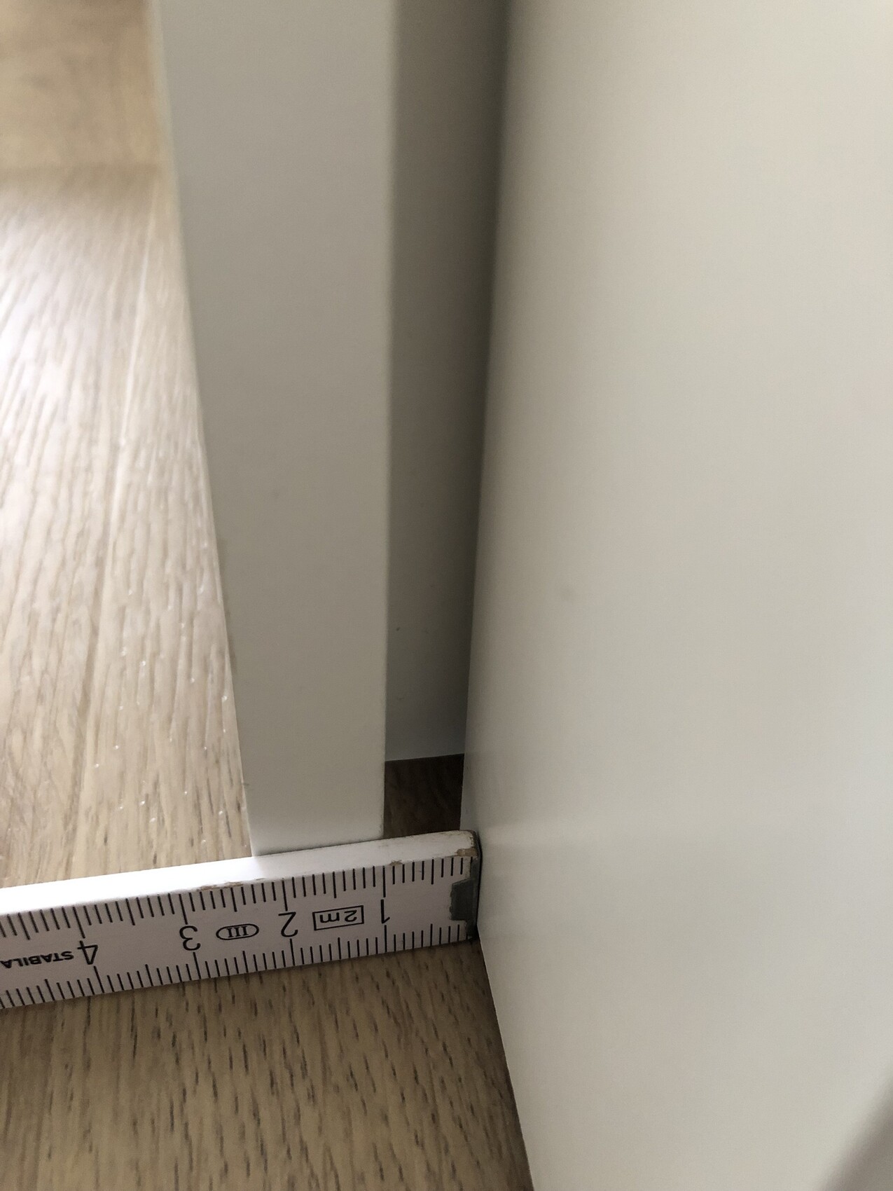

The interior doors were therefore installed by us at the beginning of this year as the final trade (rooms were painted, floors laid). I also confirmed the apparently proper installation of all doors with the fitter. A few months later, we discovered that one interior door (from the living room to the basement) is noticeably warped. The door is flush with the lock but visibly bowed at the top and bottom (like a U shape – see photo).

Close-up: wooden floor on the left, grey edge, white furniture on the right; tape measure shows approx. 2 cm (1 inch) gap.

Is the basement heated, or is it an unheated ("cold") basement? An unheated basement combined with a low-quality door can cause this.
Otherwise, this is not normal. How much has the new door leaf warped?

So, the basement is also heated, and there was no significant temperature difference. Of course, I can’t prove that.
Clearly, a new door slab doesn’t cost the earth—around 120 euros (about $130). But honestly, it’s about the principle for me. We have nothing to be blamed for, yet we’re supposed to cover the damage. It just can’t be that easy. However, a lawyer or expert report isn’t really the solution either. Although I would say, if the lawyer sends a letter, a new door slab will be provided as a gesture of goodwill.
